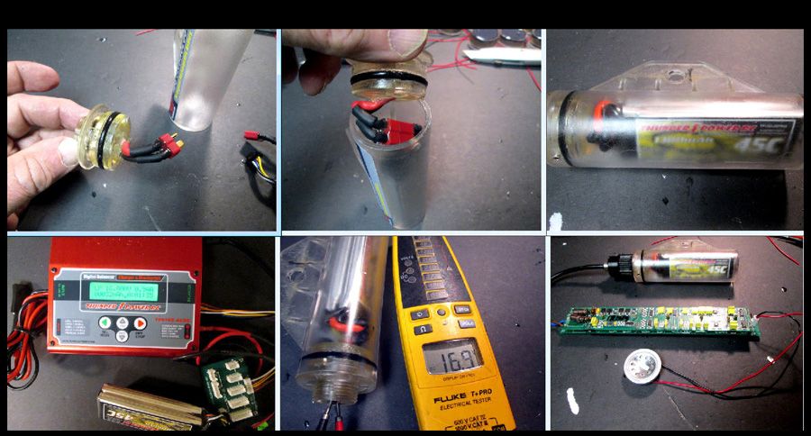

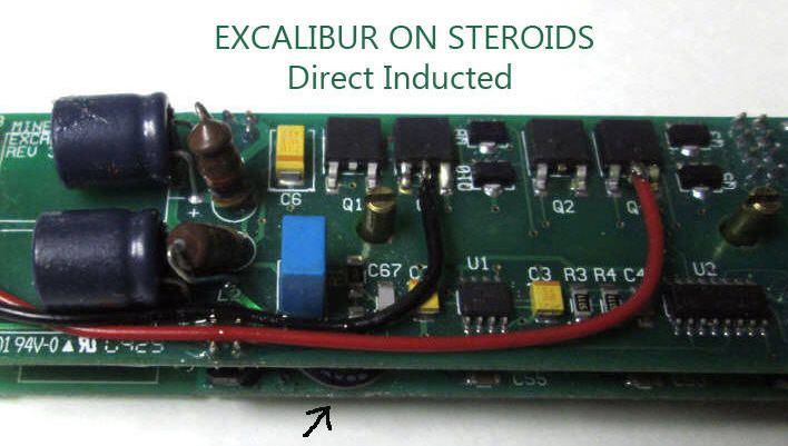

Minelab Excalibur (VLF / Multi Frequency), took what the detector offers as a stock machine and enhanced performance thru modifications.
1. Being able to change coils on a water machine is great advantage, I can go from a 5 inch Sunray to a 13 ULT
2. A great weakness to all water machines, the headphones. Instead of Piezo Buzzers...These are speakered IP68 headphones, Same speakers as the Sunray Pro Golds, Black Widows, etc. Perfect for the faints, and with the Peltor 105s 3o db rating ..along with the Gel Pads You hear targets no one else can...
3. Just like a land hunter being able to swap headphones to ones for PP hunting only, much louder because I run Doc's Treasure AMP, just like the GPX series I can separate the Volume of the target from the threshold. Bringing up the faintest of faints in All Metal/PP. Deep targets that were once covered by the threshold are now uncovered by Lowering the threshold even more.
4. Being able to run full sensitivity in PP/AM one can achieve greater depths, having this control at your finger tips for a fast toggle over to Discriminate then back...toggling to discriminate to Tone ID the target before it has a chance to false, then back.
5. Running a Hotter Battery from the stock battery voltage of 14.4 at max, Compared to 16.9 Max with the LIPO
6. And Finally direct wiring of the coil to the components on the PCB
Has all this made a difference? Gold sure has increased a lot but also I have been doing more time and learning the machine better, along with the beach.
