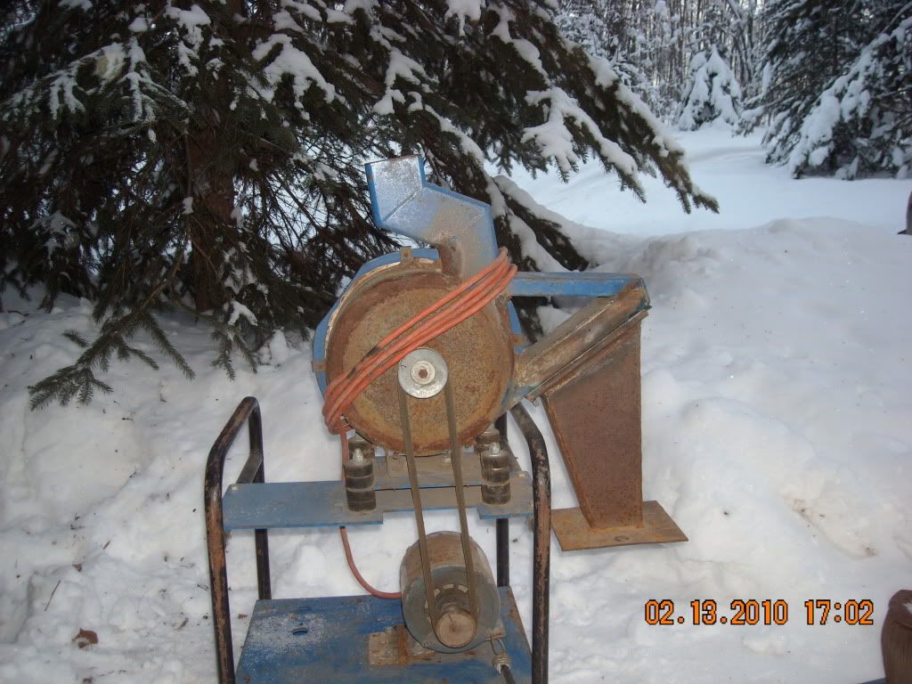

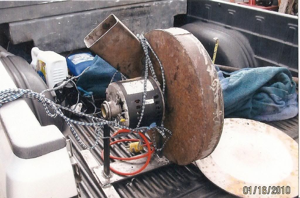

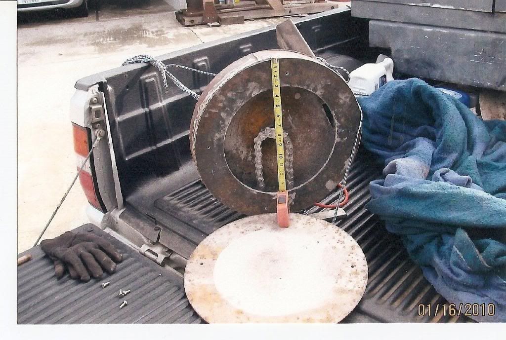

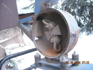

my friend made this unit for me a few years back..the first two pics were from an Alaska unit a fellow sent me.the zig-zag chute with flap would work better to keep the kickback and dust in.
on my old unit you unbolt the back and vacuum out all the fines with a wet/dry vac.The number 60 chain tore the hell out of the quartz but the links wear away and must be replaced.This unit was made from scrap,such as an old tank and 1/3 rd horse washing machine motor which are free if you look around.
It would be good to have a screw type device at the bottom of the impact mill drum to push into the classifier of your choice..sluice,bluebowl..whatever....so as to not have to open and clean out the unit.

None of this was my idea.The blue impact mill a fellow on the Alasks gold forum sent his pics to me about 6 years ago.My mill that I had a friend build for me I gave away as I no longer do any mining due to failing health.My mining partner at the time didn't like the dust it produced and was annoyed the gold came out in tiny BB like balls,ha,ha.It's all yellow to me .A Fellow worked on my Toyota truck and mostly didn't
charge me so I gave him the mill.Hope you fellows have fun with your impact mills and keep improving on them.
