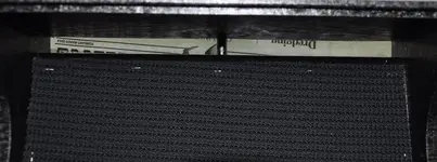

As said, I'm truly impressed with the quality of the Cube, so I was
surprised when I looked at the Vortex matting..it's cut on odd angles
and doesn't lay flat at the edges...:dontknow:
Giving the manufacturer the benefit of the doubt, I had to ask myself
if this was done on purpose to somehow increase gold retention. The other
option being they have someone working for them that's unable to cut a
straight line, and they didn't quality check their work and correct the

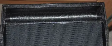

cockeyed cuts before packing it up. There is also a noticeable "hump"
in the carpet at the leading edge on 2 of the trays.
The carpet looks to be glued and stapled, so removing it will be a chore,
BUT I'm a real stickler for having things done right. I plan to work the
heck out of this unit come warmer weather, and going out with faulty
equipment means less gold in the poke at the end of the day.
There must be some purpose to having these cuts cockeyed, as everything else
was so well done from machining to packaging. If it isn't supposed to be this way
I'll have to pack it up and send them in to get fixed, or fix it myself.
Anyone else have matting cut like this, and if so, does it make much
difference in the gold capturing process?

I heard that Reed Lukens Gold Cube also had a mat that was on slightly ajar. and Mike Pung commented about it as to it still works just fine (it still creates the vortexs)even though it was crooked. If i missunderstood Mike, he had Reed return that level and it was corrected. this Vortex belting (soft top conveyor belting)is sometimes ended up (from the manufactoring)looking like that. the Vortex on my 4 stack Gold cube was good enough for me and it really works fine!Im glad i bought mine!

Russau, the more I look at it the more I'm thinking it
might work fine. Seems odd though that Reed's had the
same issue, which tells me the factory does it for a purpose,
or, for some odd reason, they've chosen not to retrain/teach
the staff how to cut the matting straight.

You must remember that the "vortex mat" is in reality rough top conveyor belting. The angle you see is on purpose for use in conveyors although some belts have less angle than others. But that does not excuse humps or edges of the matting that do not lay flat.
Here is a video of Mike and his mfg operation which may give you some insight..........
Mike is a fine fellow and I'm sure all it would take is a phone call to have your concerns addressed.
that does not excuse humps, bumps, or loose and raised ends of the matting on your cube.
Also you can purchase bilge pump hose by the foot at lowes. GG~
Now that makes perfect sense. I just couldn't imagine them installing it that
way without a damn good reason, so I'm glad I asked. Much thanks GG!
No loose matting at all...it's well secured at every corner. The "bump"
appears to be an excess amount of adhesive or ? that hardened up
underneath the matting. It's rises up about 1/4" for about an inch right
at the lip, so really don't think it'll be any issue.

We get the mat in from 5 foot rolls and the middle of the pattern sags 1 to 2 inches from the end. We didn't like the looks of this but after full testing we determined that every vortex acts independently and the angle only effects the look and not the retention. I wish it could be straighter but it can't seem to me manufactured any other way. As for the hump, use a pizza cutter or screen roller and see if it will crush the hump down. May be an easy fix, if not, just send it back and we will replace it. The Gold Cube was made to get you more gold! If you get the small you can get it all! We'll make sure you don't catch and release any more gold. Let me know if you need me to help.
