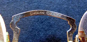

Do you have any idea what "10K CTR" would mean? Found it stamped into the bridge of some old glasses
I would guess it stands for "center" but that's only a guess, they look rimless. You can try to contact them, they are still in business- Shuron Ltd. / Shuron.com
I'm not familiar with this marking (CTR).
The best way to tell for sure is with an acid jewellry test kit. Though it only make sense that if the arms are GF, then the center piece would be too.
If you have such kit, or access to nitric acid, i could guide you to the process of testing. But it may not be necessary.
First thing first, try to file the metal about half way in and look with a loupe if there are different layers and if so, how thick they are.
This should provide you a pretty good idea if what you are looking at i.e. plated, GF or solid.
If you can't see any color differences through the cut, it may not necessarily indicate that this is solid gold piece, it maybe plating/GF over yellow brass. (that's where the acid comes in handy)
