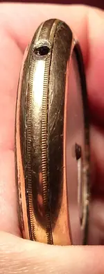

Great way to end a year! I have dug at LEAST two dozen pocket watch insides, fronts, backs, bezels... and I always wanted to find a whole watch. All the old parts I've dug have been either gold plated or silver plated... so I was expecting the same thing here. I left the dirt on it, packed it in cotton balls and had to wait.
So I get home and just run some water over it. Most of the caked on dirt just falls right off. I couldn't believe it, but I was seeing scrapes in the gold... so it doesn't appear to be plated. So I'm thinking either solid gold or gold filled. The face is porcelain... a piece of the second dial was cracked and fell off. I plan on super gluing the bits back on it. If you shine the light just right, you can see where the letters used to be and you can see "Waltham" in the middle. I took some pictures of the light hitting it so you guys can see the font on it.
How can I clean the encrusted dirt off and tell more about this watch?
I'm not trying to make this watch something that its not, but the pictures make it look plated... this was dug in a horse pasture and the soil is rough... what you cant see to well in the pictures are that the parts that are not gold, are encrusted with dirt. I took a shish kabob and scraped at some of it and it was gold under... but it appears to scratch easily, so I stopped there. On the picture of the back you can see all the scratched that tell me its either solid gold or gold filled.

I conclude the back of this thing will never come off :BangHead:
Here's what I did in my attempt to unscrew the back and get the serial number.
1) I cleaned it with Naval Jelly.
2) Soaked it in WD40 for about 24 hours
3) Ran my 0.0015 feeler gauged around the thread gaps, followed by WD40 baths and 0.002 feeler gauge. The gap between the frame and back and front bezel are totally cleaned out. Lots of crud came out of there.
After googling a lot and reading through watch forums about how the professional watch guys do it, I picked one technique from this thread (Stubborn PW case back?)
4) Loctite Super glued a 5/8 nut on the back.
5) Used wrenches and sockets on the damn thing. Broke the nut off twice and kept gluing it back on. The final attempt after letting it cure for the last time, was to put the bezel in my rubber strap wrench and stick a socket on there. The pressures were only exerted in the correct areas and no joke.... I really put some force on it.
Nut snapped off for a 3rd time.
I gave up.
Used acetone to clean up the super glue like the watch forum said to. And they were right... Not even a scratch on the back of it. I wouldn't hesitate to use that technique on a stuck back for a non-dug pocket watch.
I actually took all the cleaned up pictures above after I did the medieval torture on it... not a mark.
Looks great in my display case... stuck back and all.
