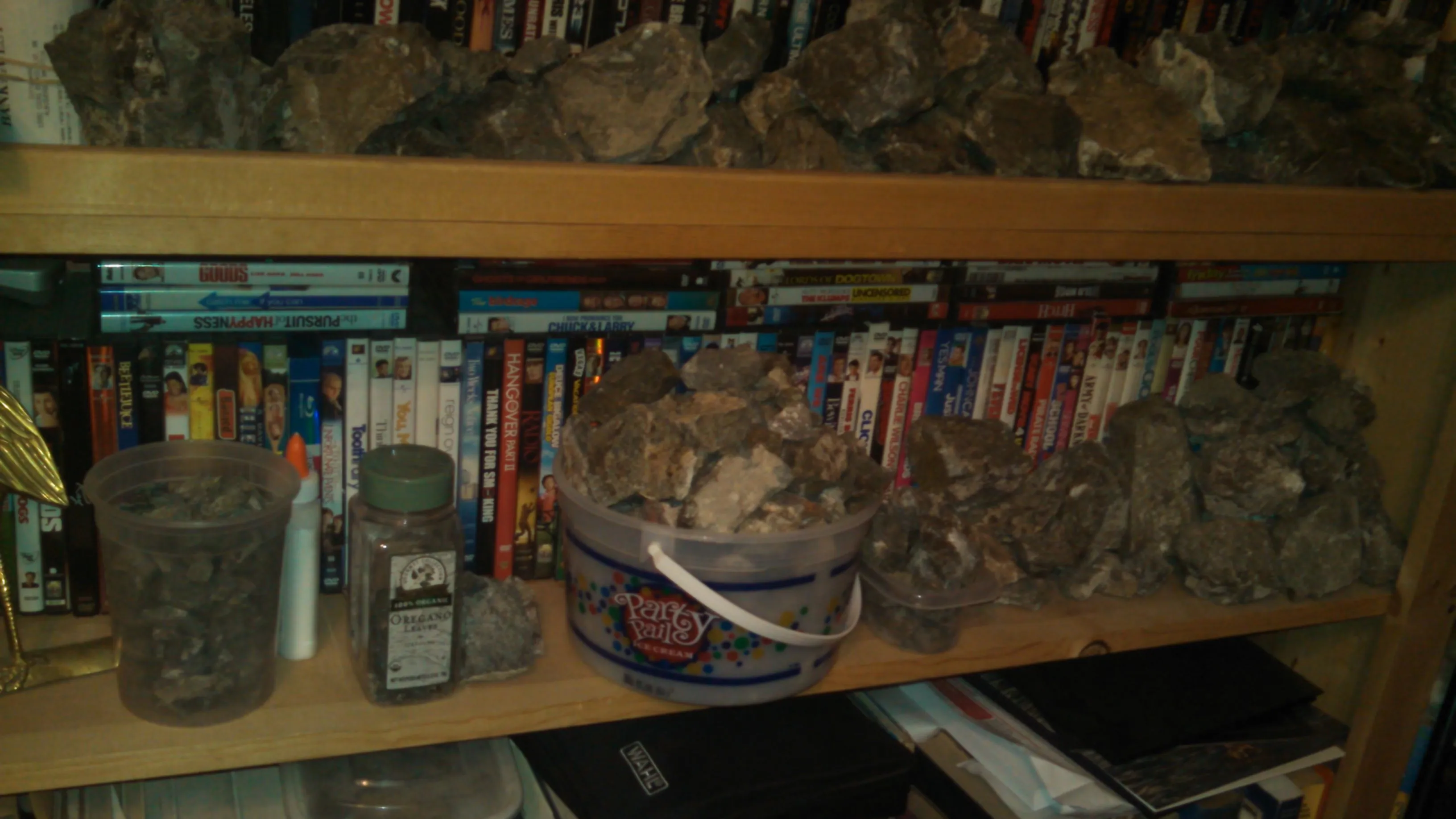

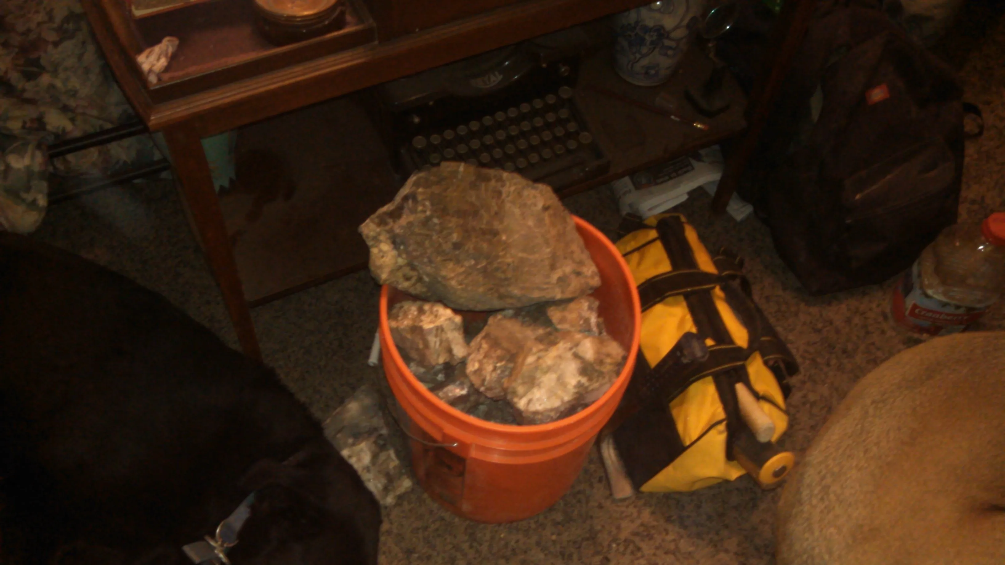

So here are the pictures of whats been pulled out of the Vein..lol there are 60 lbs more, but I'm not taking 100's of photos..

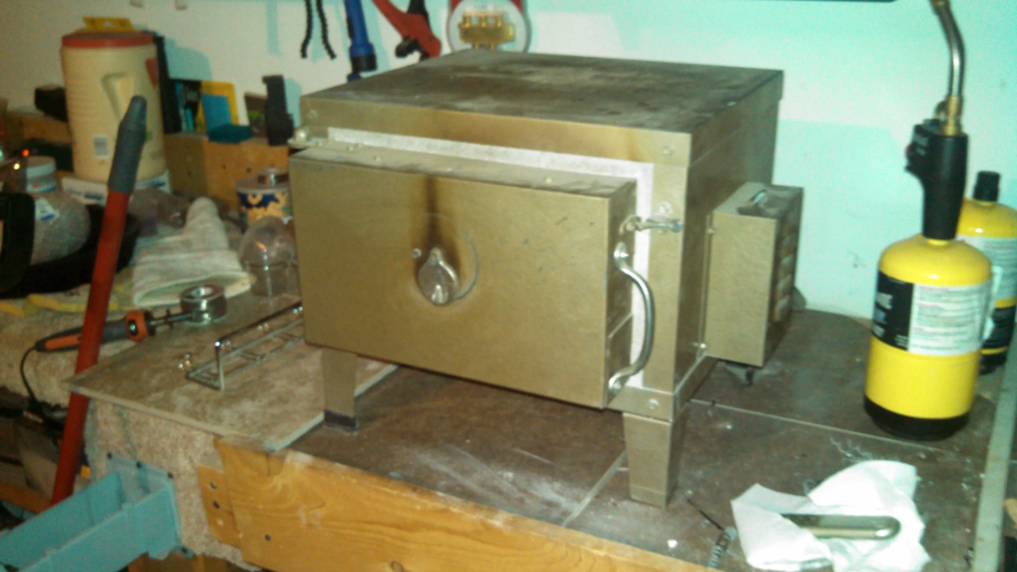

If anyone would like more photos, just hollar! anyhoo, ordering a new Kiln this Friday to melt the Panned gold down. the last firing only got to 1600 degrees,
and was a pretty bar of glass.
crushed out 5 lbs of the "Iffy" rock (wasn't sure what was or wasn't in it). and took out 10 grams of gold after panning,, not bad but i want sooo much more. Anyhoo after I've crushed some more this week ill post a pict of the panned out gold, before i go and fire it in the new kiln (2500 C) yay! not going that hot, but figured it would be nice to be able to go that hot. Olympic has a new "test fire" kiln that will do 4 crucibles and fire hot enough to melt steel.. We also pulled out more from the Vein. As we've gotten further into the face of the plume the vein has grown from pencil width to about 3/4 of an inch wide. were naming the mine "broken knuckles" due to the bashed state of mine and my wife's hands..

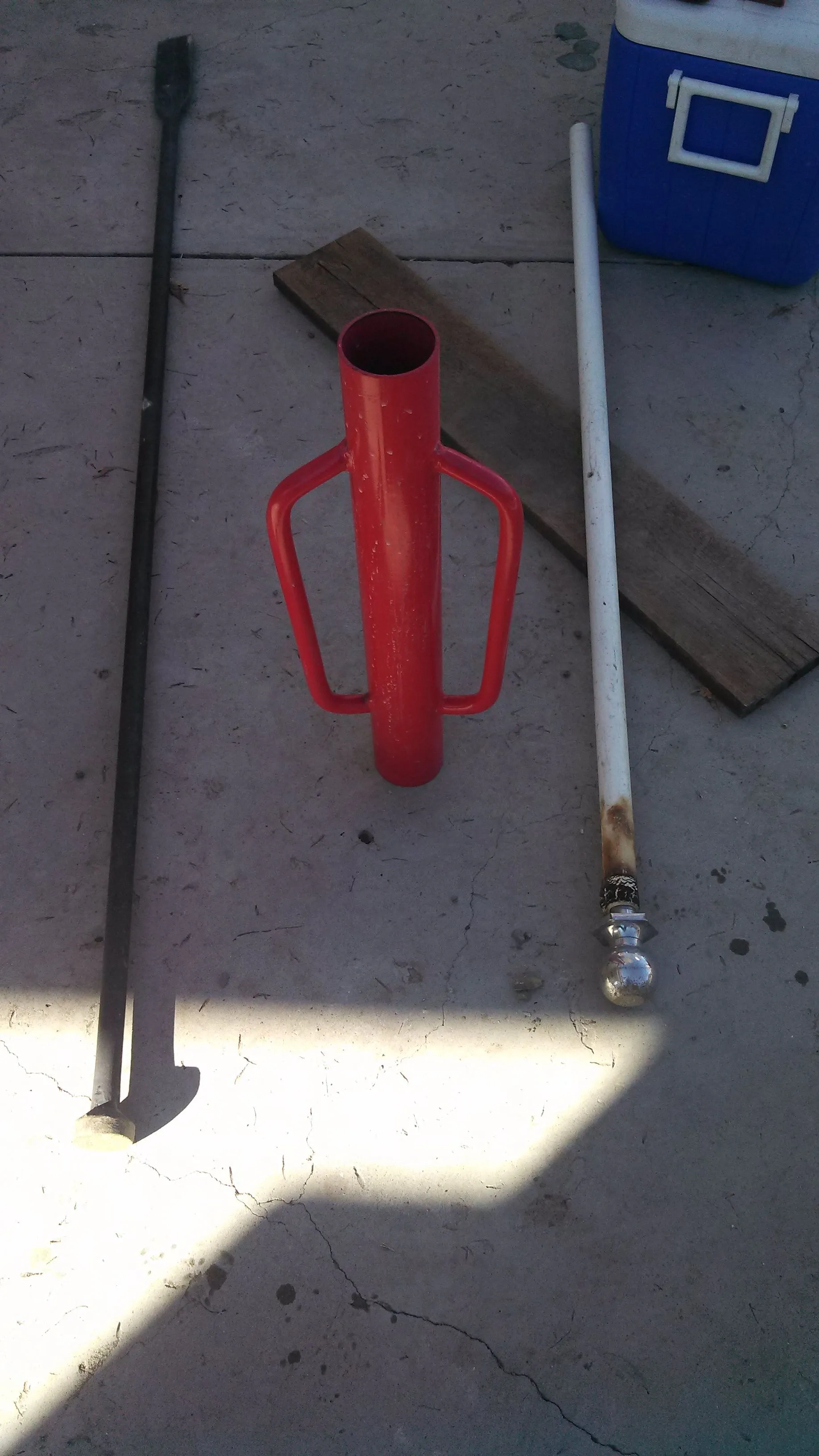

T-Post pounded 10 lbs of vein today..lol WoW I hurt.. as soon as i can I'm buying a 15" Rock Ore Crusher Pulverizer / 13 hp Gas Motor / Gold Mining / Mill 100-Mesh... ASAP.. the pounding of ten lbs of ore feels like I put 100 fence posts in... ick As soon as the gold cube is in ill post new picts!

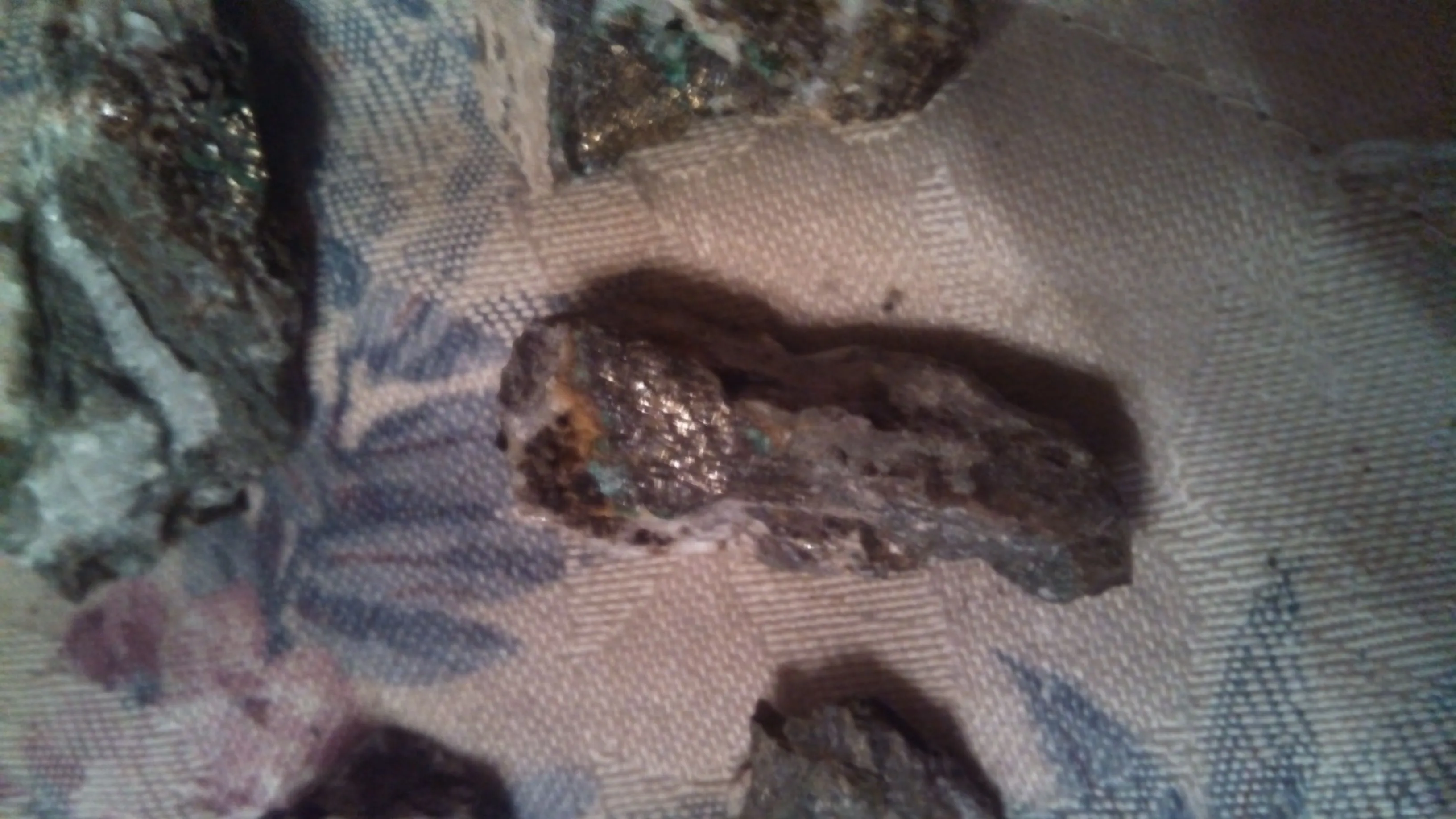

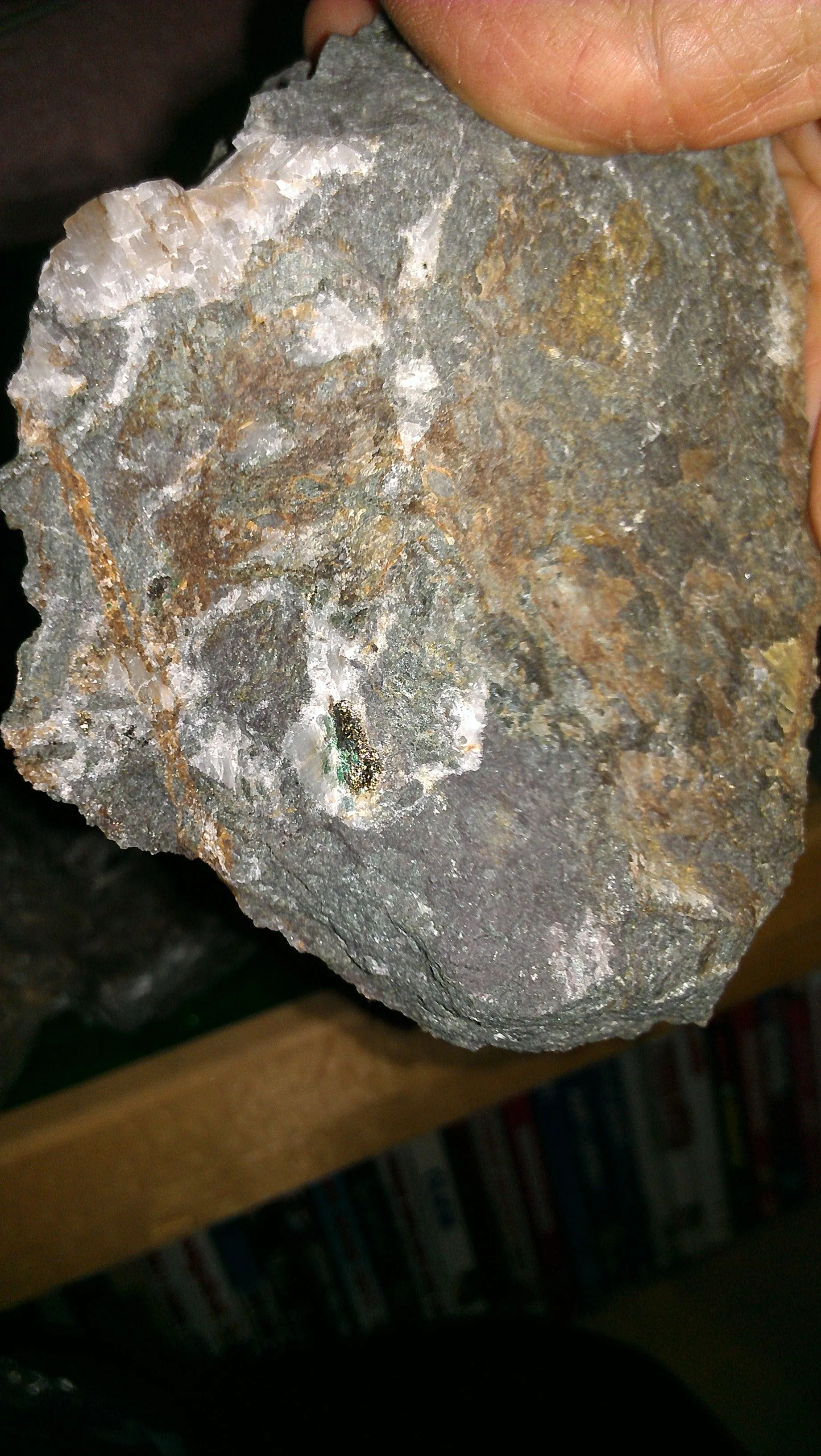

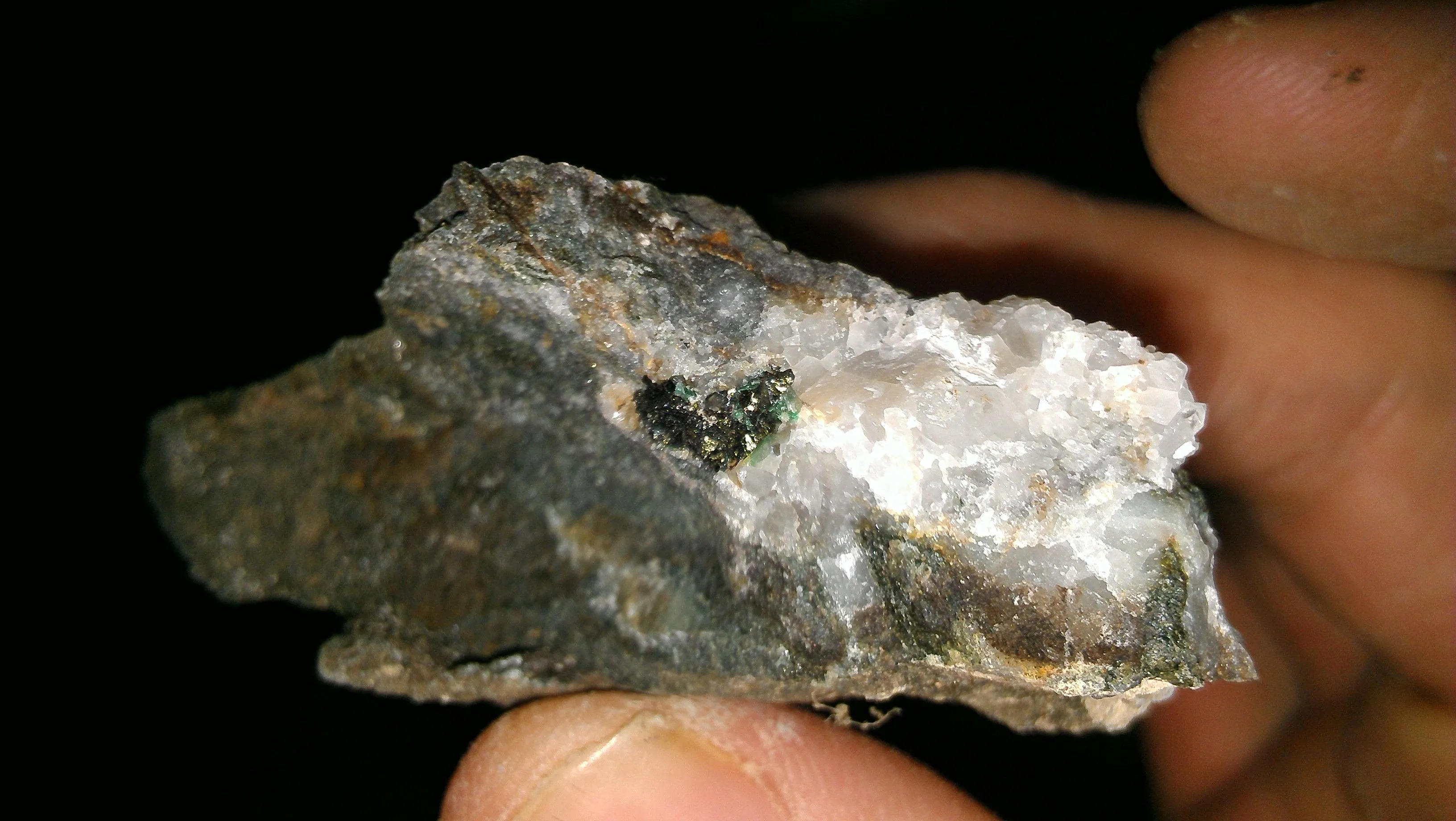

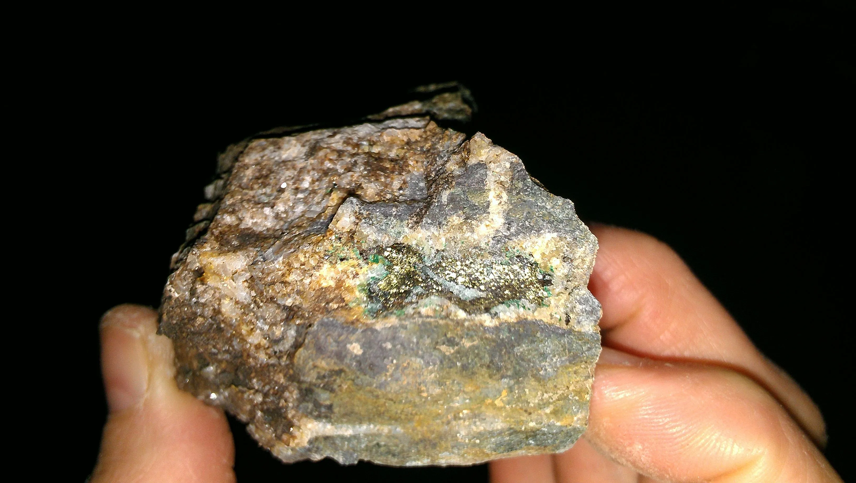

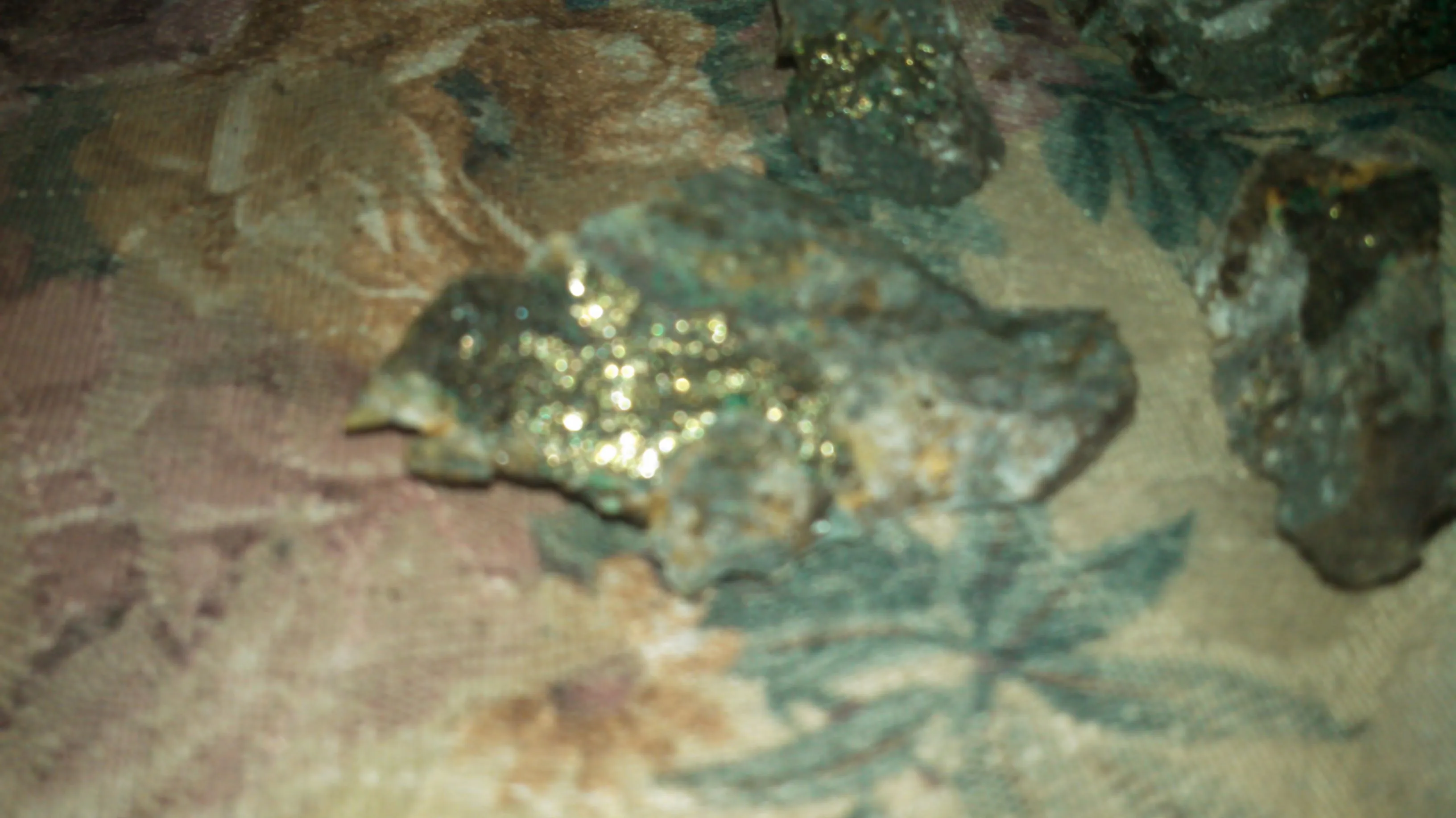

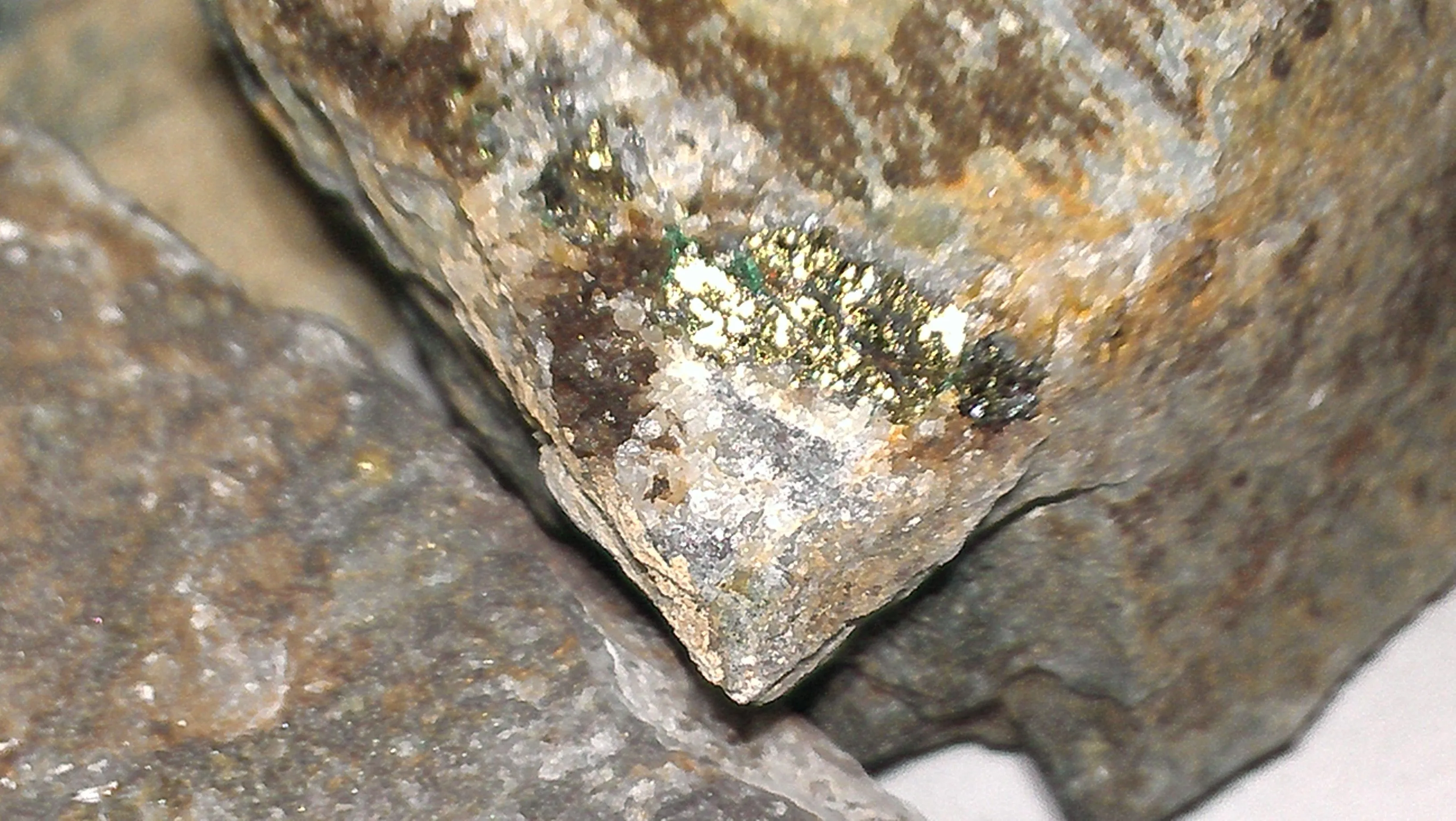

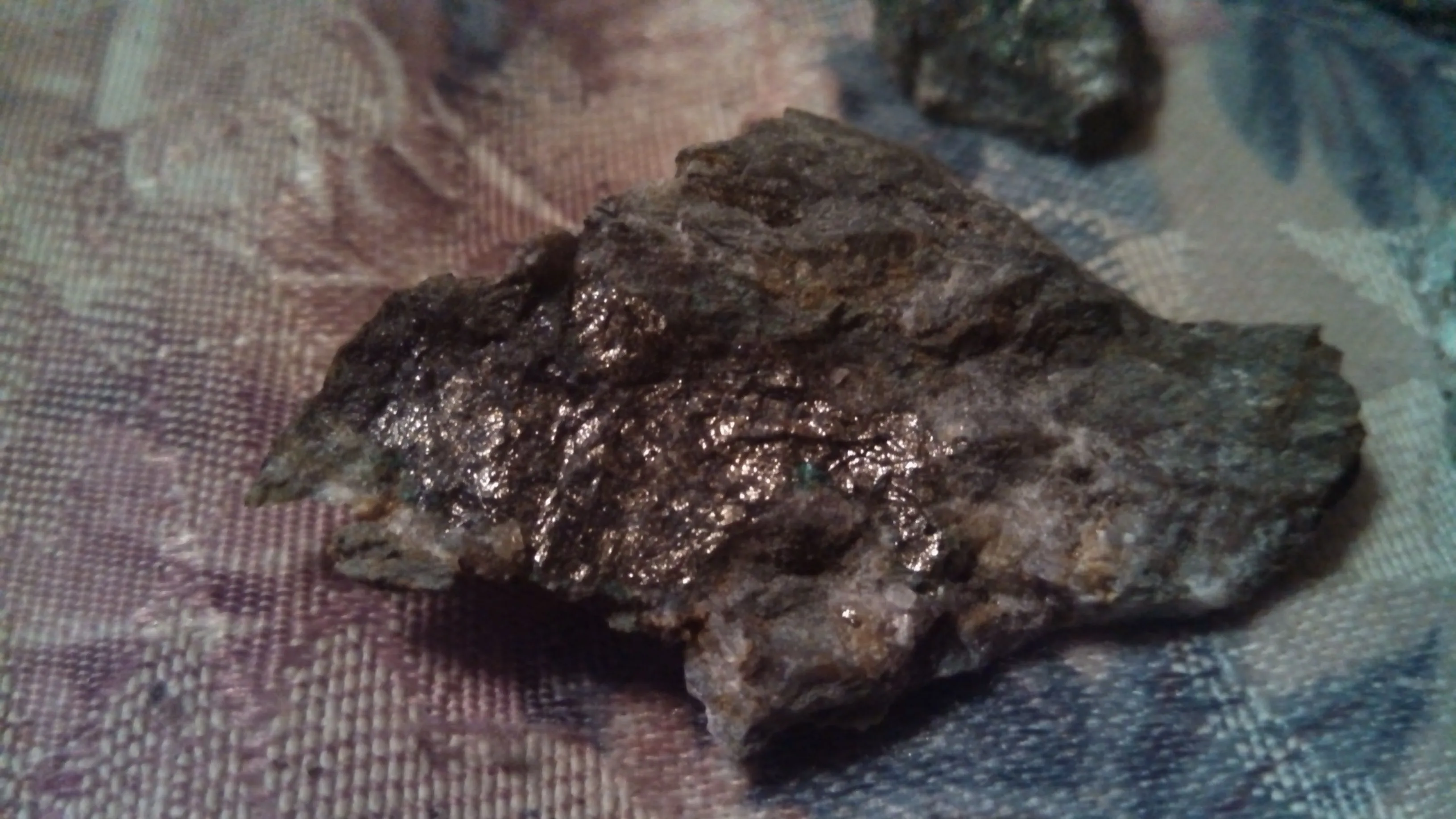

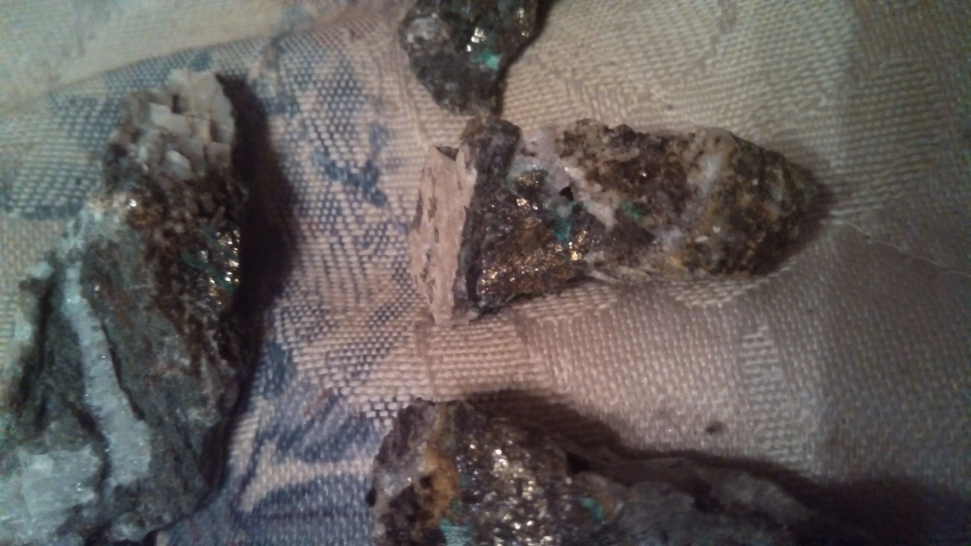

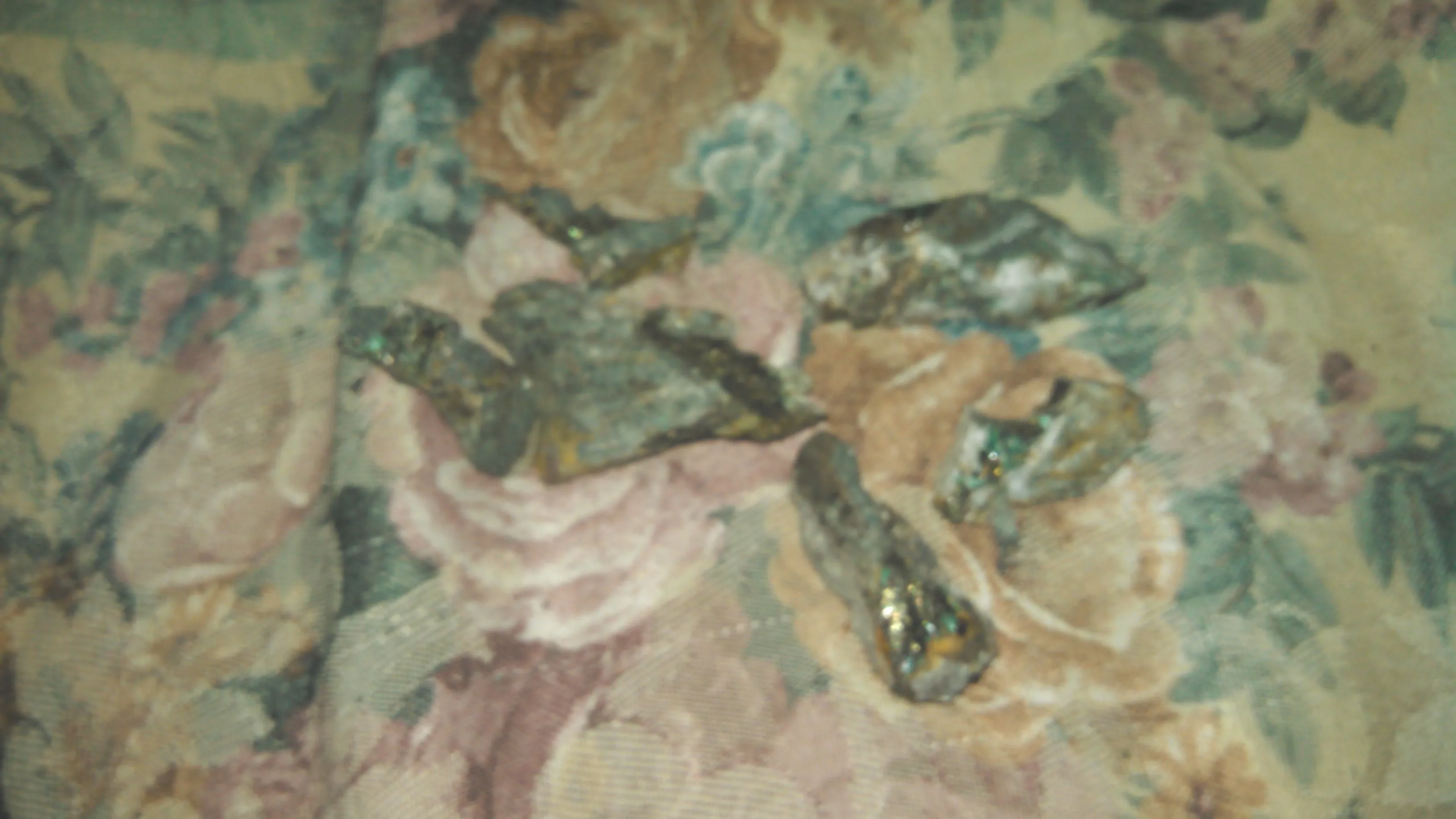

welll GOLD cube Worked well! ill post pict's tomorrow of it..lmao it worked so well i thought "Weird it doesn't want to pan out..." after close examination the gold that wasn't floating on the surface tension (WOW~!) was still stuck to some of the base rock.. after a good cleaning of the Hematite, and a thorough look in a magnifying glass we decided to go with Aqua Regia to pull it from the #8 crush.. its still got to much stuff stuck to it. But I am now a True Fan of the Gold Cube! anyhoo the gold Vein has grown to about 4 feet in width and now runs 5 feet in height in two areas,, still only 1 inch to 2 inches in depth on the vein itself. Wich has led to a new problem... These are beautiful specimens we just cant bring ourselves to crush em... would you?
IMAG0664.webpIMG_20130210_211255_026.webpIMG_20130210_211525_101.webpIMG_20130210_211552_006.webpIMG_20130210_211626_131.webpIMG_20130210_211644_241.webp
oh and if your wondering ...lol these all have the same vein... there just whole pieces that you cant enjoy as well without crushing! lol there all full of IT!.
and after that..there is 400lbs more that do not have any visible gold that we found had a decent amount... 10 grams in 10 lbs..

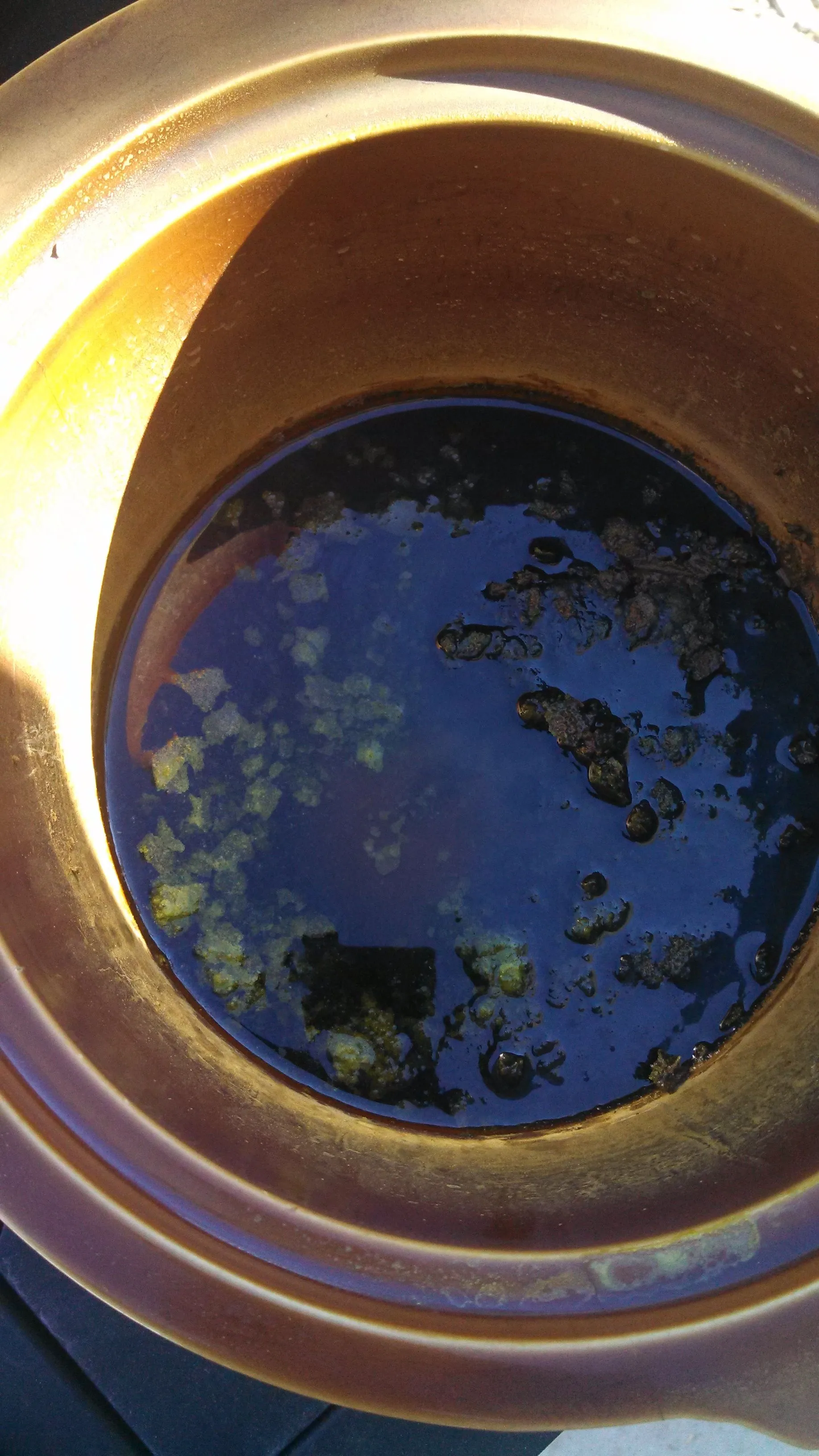

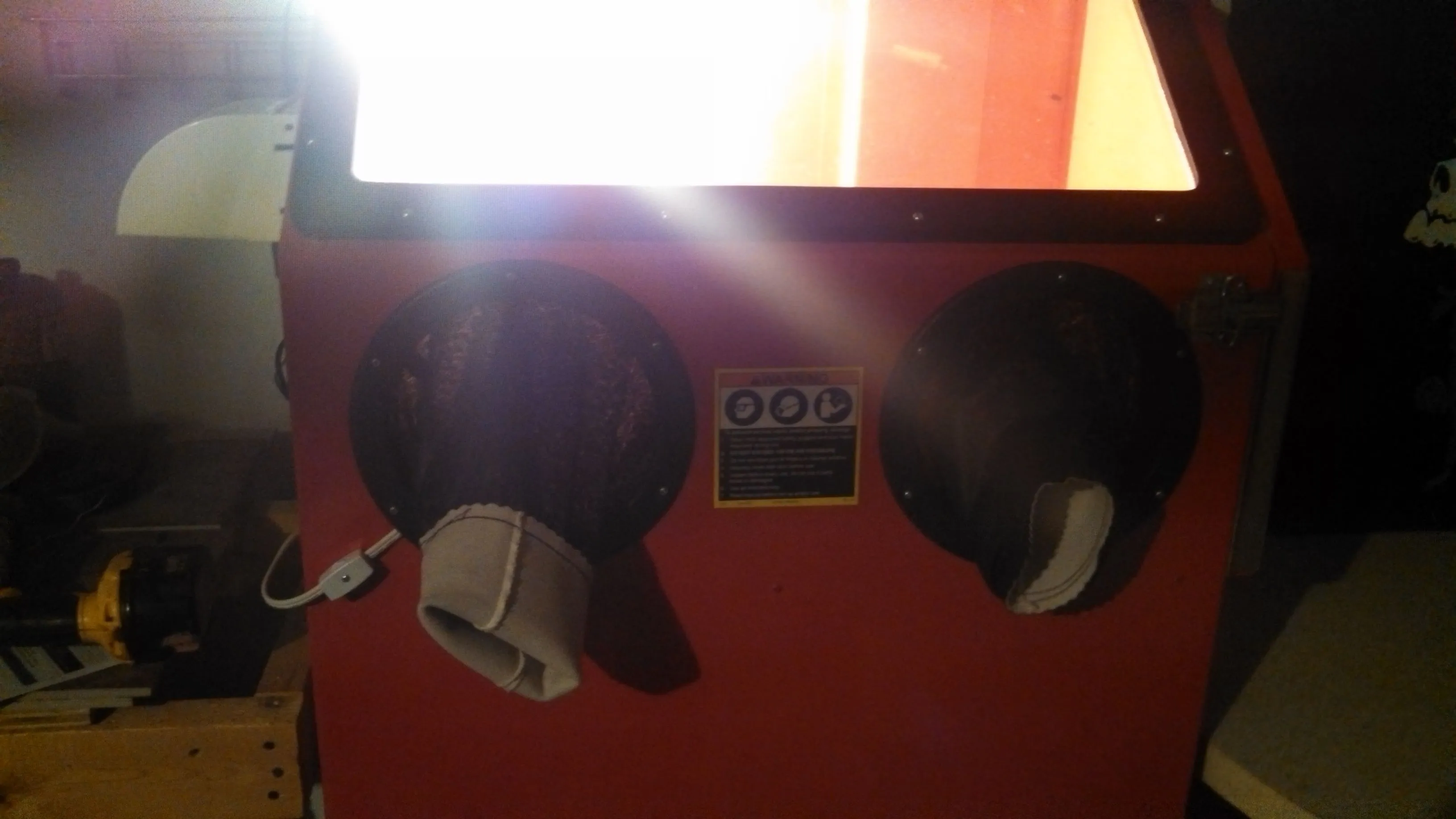

so thus far the learning Curve is a little extreme,,, we did our Aqua Regia and it ended green (too much copper) so we had to boil it downRZR 1026.webp ..afer the boil down (2days in a crock pot) we have to add the residue to nitric acid. (love my fume hood? lol its a blast cabinet with a homemade charcoal filter and scrubber on it)!RZR 1029.webp.. after another nitric acid bath all that should exist will be Gold and Platinum, thus Aqua regia dissolve again, and drop the gold out with SMB (you can get it at your local brewers supply) Sodium metabisulfite.. ITE is very important Sodium bisulfate (ATE) will not work to drop the gold. Any hoo as promised here are some of the other items Dry wash, the Gold Cube, And the kiln (rewired to hit 2300 Degrees) OO and my temp Rock crusher!RZR 1027.webpRZR 1032.webp ugg! files to large for some! ok so i will take new ones smaller...
