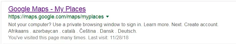

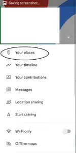

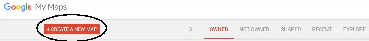

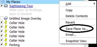

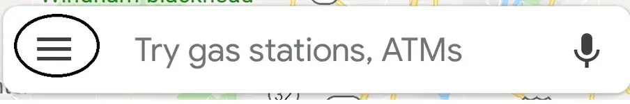

Download the "My Places" folder on Google Earth (right click it and click "Save Place As"), and saving it to my "Documents" folder on my desktop (though you can save it anywhere). Then search "My Places" on Google Search, click the first result titled, "Google Maps - My Places". remember to be logged onto your main email account when you do this. Click the red "Create A New Map" button, click the blue text that says, "Import", under the "Layer" text. Then click "Select File From Computer", and find "My Places", wherever you decided to save them. Now your places will be saved to your gmail account, and as long as you are using that account in the phone app, you should have them there. Click the "My Maps" folder on your phone, and your places should now pop up (they won't be there unless you click that). It is really much easier than it sounds, and should only take a couple minutes once you get the hang of it. Good luck, and let me know if you have anymore questions!
