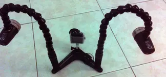

I want to shoot some videos when I'm scuba detecting. I just bought a Gopro 4 and a pair of Light & Motion Sola 3000 lights. I will put the Gopro on a Helmet and the lights will use loc-line arms, placed on each side of the helmt.
Do I need to use a red filter on the Gopro when I'm using the lights?
Hope someone can help me as I am a total newbie in underwater video and photography....

You bought a pair of sola 3000's ?! Holy crap that's a lot of light! Thats professional video level of light. You will need a color correction filter if you are shooting anything more than a few feet away, I recommend a flip filter so you can use it as needed.
Edit to add- be sure to use the lights in the flood mode, not spot.
The lights are only flood mode 90° wide angle. I just can change the power of the led 3000 / 1500 /750 lumens I think. I bought a Red filter from SRP which can be easily flipped from the GoPro. I'll make some test with the filter and without, but it is better to have the good advice before diving :notworthy:
Be sure to play with it a lot. Do test films with the different power levels, different natural light conditions, with and without the filter each time. I doubt you will need the full power setting, but it's always good to have options.
I have a pair of the sola 1200 and have tried both with and without the filter. I found I could get within about 1-2 feet of the subject before the filter began to over-tint the video. so 99% of the time I just leave the filter in place now.

Here's the pictures, I am building a lanyard for the lights with fishing monofilament. I'll will pass it inside de locline arms
IMG_0807.webpIMG_0808.webpIMG_0809.webpIMG_0810.webpIMG_0811.webpIMG_0812.webpIMG_0813.webpIMG_0814.webp
I have for 4 locline arms, 2 long for the tray and 2 shorts for the helmet light mount
Just to clarify, I was refering to the locline, not the solid handles you showed. The locline is designed to be a hard/flexible hose so it will hold air and or water if it doesn't have a drain option.
Also, you have WAAAAAY too much locline! 1/4 of that would be plenty for 2 lights.

I will use 2 loclienes arms for the helmet that I don't want to remove (only the light), and 2 arms for the diving tray that I don't want to remove either. That's why I have 4 arms :-)
I will drill some extra holes on the top and base of the locline to drain air & water! Really thanks for this advice !!!!!!
OH, OK... That makes more sense, but I bet after playing with your setup you end up shortening the helmet mounts. It's hard to tell from the photos, but to give you perspective, I use 12" of locline for each light from my camera housing. You are basically pointing them forward with just a little inward direction so you only need enough length to get them a little bit away from the camera.
If the lights are too close to your lens (pointing straight forward), you get backscatter (snow) in the video. If you move the lights too far away you lose light power and coverage for shots that are too close or too far from the camera. It's a lot more "art" than "science" so it will take some practice and play. You might see if any local dive shops or clubs are giving any classes in UW videography. It could shorten your learning curve.

I have just finished the diving tray: it will be used by my diving mate or I'll use it to make some videos of him.
The video & light helmet is under construction, will be finished by the end of this week...
The tray configuration :
GoPro 4 Black, 64Gb sd card for 4K, diving housing, lcd screen
1x GoPro aluminium arm extender from GoMountz
2x Sola Video lights 3000 - 90° light angle (wide) and 3000 lumens per light.
1x SRP aluminium tray
2x Loca line arms
1x SRP red filter, easily removable.

I did some tiny holes on the locline arms and I don't have any air/water problems : thanks or this advice!
