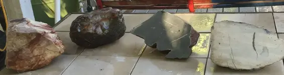

I just have a few weird pieces I cant ID.
Pretty sure but not 100% that this is Basalt. It scratches black. I did NOT tumble this piece. I kind of thought it was prettier raw. It'd make a pretty costume jewlery ring, pendant or or something. How do I clean to bring out the crystals?
Most predominantly the rock with the pock marks? Lava rock? I think the other two are shale or granite.
The weird duck shaped piece though and the piece next to it? It's not heavy. Could be red clay, iron oxide... Easy to scratch.. Scratches brown. I didn't check the tumbler for the past 2 days so I think most of my grit I think collected into this hard duck shaped thingy. I didn't put a piece in there that looked like this. Very malleable.
It reminds me red clay with that yellow buttery sand stuff I was telling everybody about. I threw some of it in the tumbler to see what would happen...
Any body have any clue what is the yellow buttery sand in the pockets of the clay? Or what the quartz part of the rock is? The one next to the duck shaped thingy is really heavy.
That yellow butter sand stuff... It forms loose pockets in the red clay. It is buttery yellow like gold but it's... Poofy and it's not shiny. What is this shtuff? ???
The one with the little veins in it looks like oceanic rock... kind of reminds me of ocean rock with fossilized coral.
