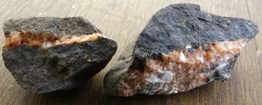

Got A Rock you Want Identified? Post it here! gimme a good picture or 3 or 4!
The first is with flash on and is a decent rep but the transparency is milky closer to the top and bottom and is clear in the middle. Is this an algae or natural colorization? I tried the bleach suggestion to remove possible algae...no change. It doesn't appear vivid enough to be emerald and darker than most peridot I have seen. It was originally found on a white quarts chuck that I found hiking in the woods. I assume another layer of quartz was on the other half due to the same marks after this broke off the main chunk. It is brittle, this piece here just broke in half when it fell on the floor...what is it?View attachment 1421046View attachment 1421047View attachment 1421048
The images aren't quite as focused as I'd like them. But did you consider it's just quartz?
Green inclusions can occur in quartz, giving it a green colour, especially so if the quartz during formation chemically acted on the rock surrounding it.
I'd say, it's natural, though.
