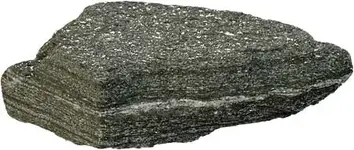

Thanks! The first appears to be a fine-grained Schist.
Here is an example from the web:
