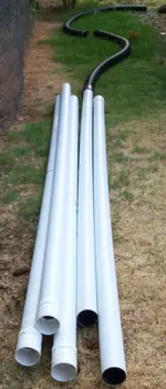

Running about 100 ft pipe, is it better to use the top end for the suction intake or Y into it at a certain point and use venture effect for suction
Not sure if I am asking correctly or not
Rick
Run direct. I'll be playing with gravity this weekend running direct with no splits or Y's. I did a test last weekend in my creek with 20' of 1 1/2" pool hose, smooth bore. We had 3-4' of drop which surprisingly provided a decent amount of suction. We filled a 5 gallon bucket with material in less than 10 minutes. I know it doesn't sound like much but if I were to dig, classify, sluice, I would only be able to run 6-8 buckets an hour depending on material.
It seems to me that placing a Y anywhere along the line would actually reduce the head pressure at the suction end. I'm new to this as you are and I've learned a lot from trial and error. So play around with it and post your results, with pics if possible.
don't use Y's.
here's my setup.
a lot of people don't like this setup. but I don't think they've really tried it. works great for me as long as I'm nice to the pipes.

Because there is no motor to give you the extra suction, plan on at least a 4 to 1 ratio for pipe size if you just have a few feet of drop. Plan on an 8" pipe maybe moving 2" cobbles. It will move a lot of them at once but you will need to experiment with what makes it through. A plug up in a gravity fed hose can simply be a sand plug caught behind a rock that gets stuck in the hose. For me... 8" is minimum, 12" moves a lot more but will drain a small river quickly. 6" works also but just not fast enough for me... but... it works. for gravity dredging, the bigger the hose, the better the suction :)

Straight if you have a good run and pipe.
A y with venturi if you have a hundred feet good fade and the roll out abs
I've tapped into a stream box/ wier and ran into a tank in the eastern sierra. I used tank volume to hold back the pressure.
The owner tried several times to go straight to the line and kept blowing hose bibs and cracking pipe. You can build a lot of pressure with two inch line and 20 ft of drop from the source.
