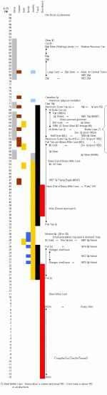

New people that detect are often overwhelmed by too much information. Try learning your machine and what actually works for you. Rely on the book that came with your machine. Set some coins, a ring and other metal objects in your yard and see what signals the "good stuff" gives you. Try some bad stuff too.
White's machines generally have a very good ID meter and the different tones will indicate what is what in determining certain objects. Try this approach and just dig the stuff you know is good. As you learn your machine, try to find the deeper stuff through trial and error.

When I first got a detector with a visual Target ID display I took one of every coin in my collection and put them in a vinyl flip and spent some time with them on clear ground seeing how they registered. I also began keeping a small spiral notebook with the ID number, depth and denomination/date of each coin I found. Sounds like work, but here is the result.
Now I have much more confidence in what I am detecting before I begin digging. I still dig tabs. Anyone who wants jewelry rings will have to dig some pull-tab rings. That's just the nature of life.

Wow! Thank you for all of the quick feedback! I can honestly say all replies up to this point have been EXTREMELY informative. I will be studying the "graph" (for a lack of better word) starting now. Thank you very much.

Remember: that chart is for a different make & model of detector. But it's a good starting example and probably a relative representation. Conductivity is conductivity and that's what detectors detect.
Here's the numbers for an MXT, the M6 is the same for VDI numbers. Just remember this only works some of the time. For example nickels will usually read 18 - 20 on our detectors but I've found them as low as 16 and as high as 24.
