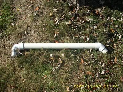

If I am working a creek with lots of crevices in shallow water and close to the bank, I use a gold sucker like this:

I don't get it....if you are out in the middle of a stream where do you dump a thing like that? Are you reduced to running back and forth?
If I am in the middle of a creek, I take my bucket, put a rock big enough to hold it down, and put it underwater. I have work in up to 2, 21/2 feet of water like this.
oh right...of course. Duh, sorry for even asking!
