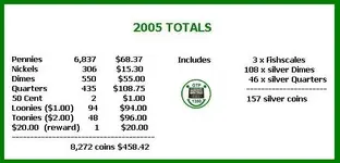

Below are my finds for one complete year using the GTP 1350:
