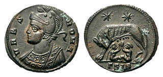

I have 7 Ancients that I can't ID.
I'm sure someone can help...

OK, Folks,
I got my computer fixed and let's try this again....
#1
#2
#3
#4
#5
#6
#7
I hope this helps with possible ID's.
Best Wishes,
Scott​
First one appears to be Constans obverse; reverse is two victorys facing each other, holding wreaths, upright palm branch between them (obscured). Mint mark may be SMTS (Thessalonica--Salonika, Greece).
Don.......
PS: This may be more precise:
Constans AE3Obv: CONSTANS-PF AVG, rosette diademed, draped, cuirassed bust right Rev: VICTORIAE DD AVGGQ NN, Two Victories facing each other, each holding wreaths and palm branches. Mintmark SMTSB. Palm branch upright in centre. RIC VIII Thessalonica 105, rated scarce
Third one may be
VALENS (364-378).
Obv: D N VALENS P F AVG.
Diademed, draped and cuirassed bust right.
Rev: SECVRITAS REI PVBLICAE
Mint mark may be SMN: Nicomedia (Izmit, Turkey)
Don....
#6 may be Constantine I on obverse; reverse showing 'quadriga' facing right with right hand of God reaching down to him.
Don...

Ten years later....sorry I'm late: Here's an update on your coin #6.
