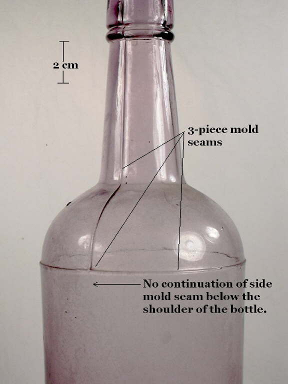

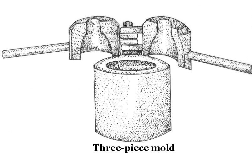

If the mold seam runs all the way to the top through the lip then it's not that old. It would have been made by an ABM. If the seam stops shy of the lip then it's blown in mold with an applied or tooled lip. If the seam runs up to the start of the neck and then has a circular mold seam around the neck then another seam running to the top it is a 3 piece mold. Hope that helps. Both of the latter ones could be late 19th century I think. HH
"...Morphologically, three-piece mold bottles have a horizontal mold seam encircling the bottle where the shoulder and body meet and two mold seams on opposite sides running vertically from the shoulder seam, up the shoulder, and variably up the neck and/or finish. Click on the small picture to the right to view a close-up of the mold seams on the shoulder and neck of this late (1900-1910) mouth-blown, three-piece mold liquor bottle. Some neck seams disappear right above the junction of the shoulder and neck, particularly on the earlier Ricketts' bottles which were not molded above the shoulder (neck formed with post molding tools). Later side mold seams end immediately below the base of the applied finish (1830s-1880s), and the latest three-piece mold bottles (1890s into the early 20th century) may have side mold seams ending within the improved tooled finish, like the bottle pictured to the right if one looks closely. Three-piece mold bottles are not embossed on the body of the bottle, though may have embossing on the shoulder (fairly common), neck (unusual), and/or base (very common).
Most bottles which are commonly referred to as three-piece molds were actually made in a mold that had at least a fourth base plate piece, like already noted for the Ricketts' patent mold bottles. The bottle pictured to the left also had a separate base plate even though the bottle is largely unembossed (there are mold numbers very faintly embossed on the base). Click three-piece mold base to view a close-up picture of the base showing the base plate seam ridge (mold numbers not visible). Use of a separate base piece undoubtedly made construction of the mold easier. Although most three-piece mold bottles actually had four mold parts, referring to them as "three-piece" molds will certainly continue due to its ubiquitous use over the years. To suggest changing the name would be confusing and unproductive since most people understand what is being referred to (Toulouse 1969b). What is called the four-piece mold is a variation of the three-piece mold with two body halves; it is discussed in the box below..." Bottle Bases Page Thanks to Bill Lindsey.
