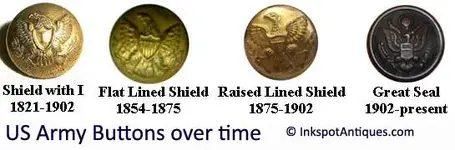

What makes you say it is the older type versus the 1875-1902 version? I thought the shield looked like the younger version since it looks smaller than the older version shields?
I was using this picture to try and compare. Thank you for any insight.

It's not the size of the shield that matters, it's the shield's "height." We button collectors call the 1854-74 version the "raised-shield" eagle button. It's as if somebody carved a tombstone into a shield shape, and laid that slab on the eagle's chest. If you look closely at the top of the 1875-1902 shield in the Inkspot photo (or the photo attached below), you'll see "the edge of the slab." On the earlier versions of the eagle-button, the shield is not high-raised.

Ok, I think I can tell the difference. I'm thrilled it's the older version! Much appreciated!
