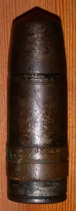

Hope you can shed some light on what these may be.
The bullet in the middle is a 50 caliber.
The one on the left is steel and measures
36.70mm +/- at the base
38.00mm +/- at the rifling lands which are copper or brass
36.70mm +/- above the rifling
28.75mm +/- at the top
and 113.00 total length
Now the one on right I have no real idea if it is part of a round or not.
I'm thinking that it maybe the fin section of a mortar shell. or it could be farm equipment parts.
I see I made a rookie move and mixed up the items in my last picture, but I'm sure you can figure it out.
Thank you for any help on the two unidentified.

Mortar shell fin is my vote.
Fins looks like the back part of a mortar round. Other one looks like a solid tank or howitzer training round with a tracer hole in the base. I don't know why it's it so flat at the front though.
The projectile on the left is a World War 2 era M59 APC (Armor-Piercing-Capped) 37mm Solid-Shot (non-explosive). For verification, and to see the cap's internal structure, go to the following link and scroll about halfway down the webpage:
An Introduction To Collecting Artillery Shells And Shell Casings - International Ammunition Association
The many slightly-diagonal grooves on your specimen's brass sabot (also called the driving-band) mean it has been fired from a rifled cannon.
Jason, as the photo shows, this projectile's nose was shaped like a watertank tower's low-angle roof when it was made... and straight-on impact with a thick solid metal object (or perhaps a granite boulder) flattened the projectile's nose even further.

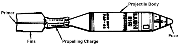

After a quick measurement of the fins on the Mortar it is 80mm across the fins, so I'm thinking M252 81mm Mortar.
The M252 81 mm medium weight mortar is a British designed smooth bore, muzzle-loading, high-angle-of-fire weapon used for long-range indirect fire support to light infantry, air assault, and airborne units across the entire front of a battalion zone of influence. In the U.S. Army and U.S. Marine Corps, it is normally deployed in the mortar platoon of an infantry battalion.
similar to this...
