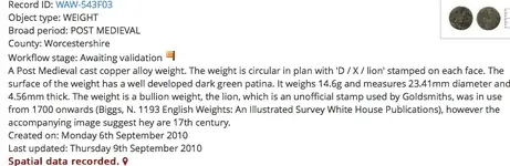

This one has the numeral/lion combo
Screen Shot 2017-05-07 at 12.25.14 PM.webpScreen Shot 2017-05-07 at 12.25.26 PM.webp
If its not a lion it might be a poorly struck ewer symbol rotated 90 degrees counter clockwise
