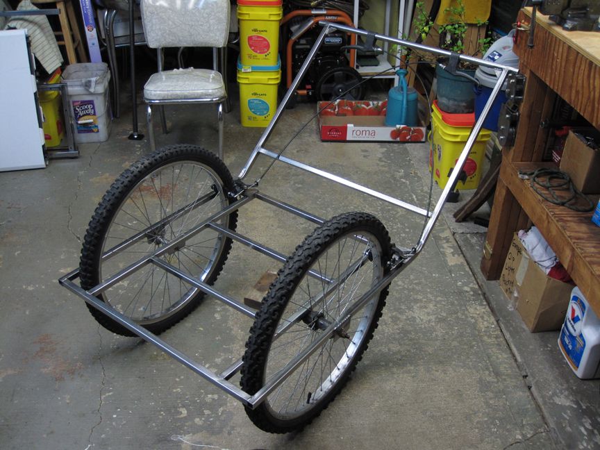

I had made another cart up over the winter. Matter fact just got done painting it.
Sometimes my projects just seem to go in slowmo. But here is a picture of it. Brakes are a must if the terrain is less than flat.
I use these to haul the heavies (Motors, pumps, winches...). :tongue3:

GH fab job rocks,as usual, and see the brakes too!!. The outside bar over the wheels is a great stability edition as really makes the frame much more rigid and helps keep brush outta them spokes. All you have to figure out is the center of gravity on whatever your hauling and good to go for many pain free miles-cool tool-John

Thanks for all the ideas..... That is one nice looking cart by gravel hog. Nice.....

looks nice gravelhog .I need to make one , a little larger . like the brakes
