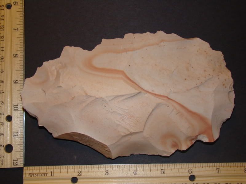

Here is a rough preform that I knocked out of a spall of cooked Keokuk Chert today. I love this material because you get a lot of 'strawberries' and pink lines through it when you heat treat it.

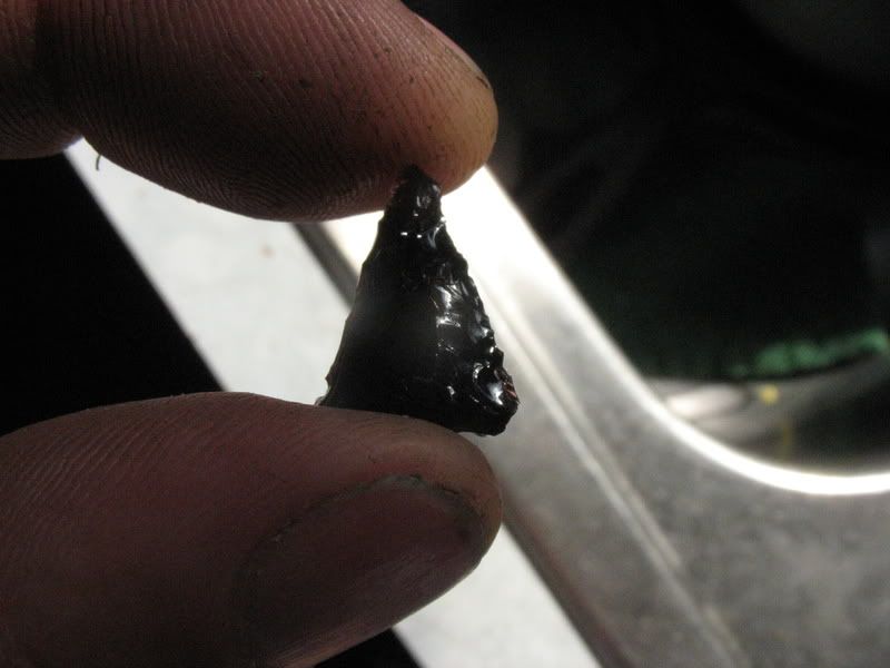

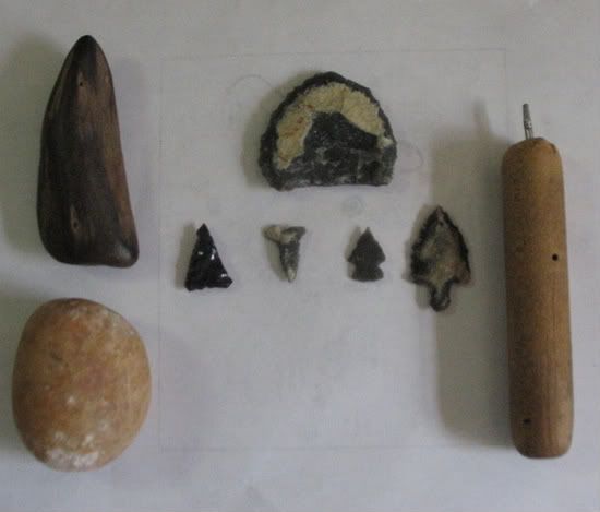

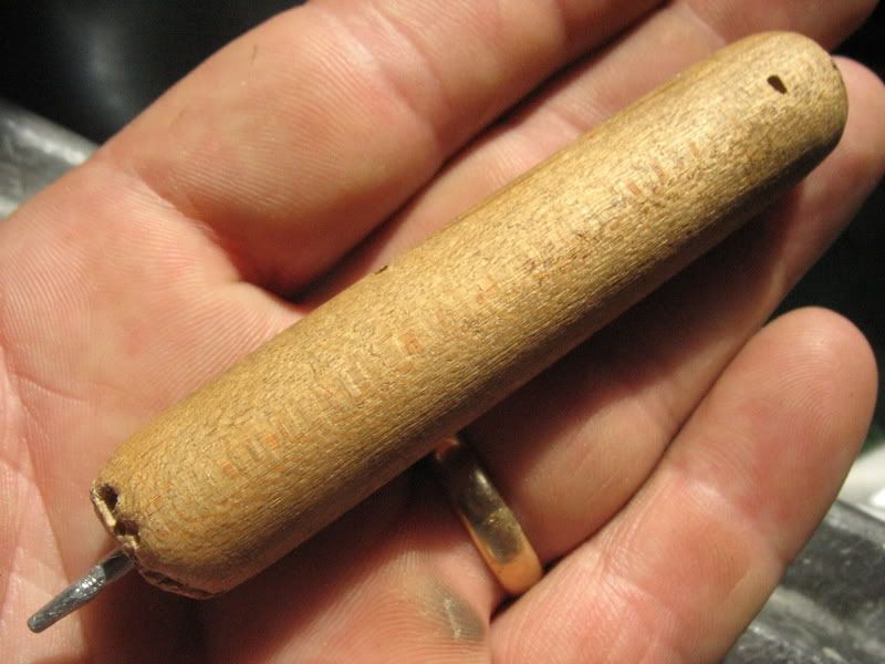

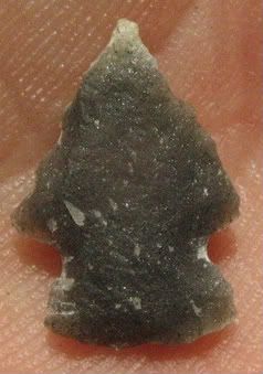

Okay, I now have a new SD card so here's what I've done so far plus my tools.

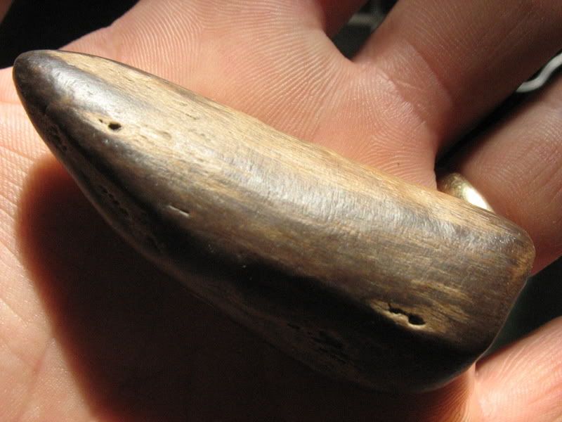

The brown thing is actually petrified wood I scored in a creek.
Not much, but it's a start and I like doing it.

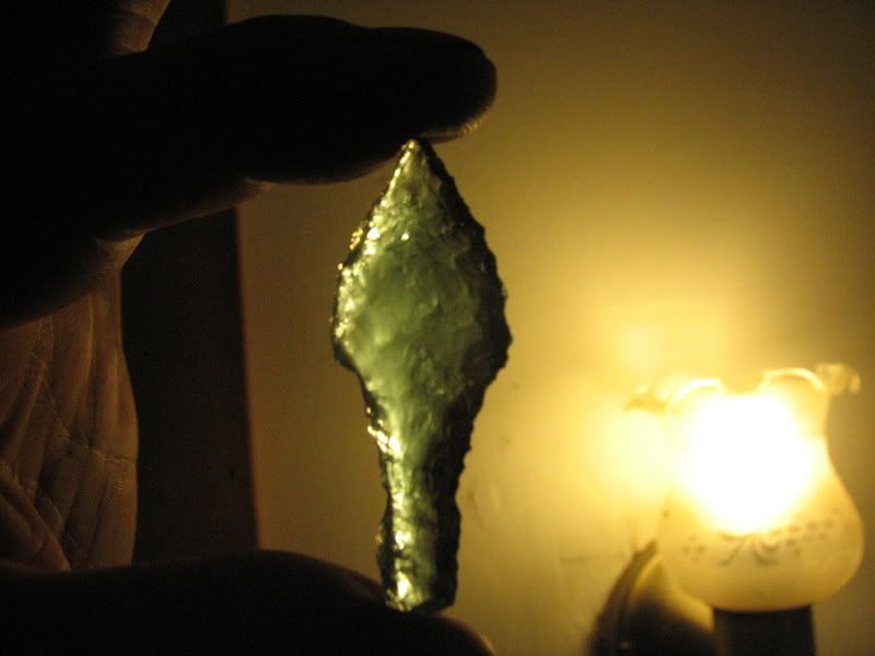

Okay so I used up the blue glass base I found at an old homesite.
I had no real plan one what it would look like when I started, I just kind of went along with the flow. I did notice that I REALLY need a leather pad or something, glass flakes are freaking sharp!

GL,............Dude!...........Please get some leather! I can feel the cuts and smell the blood. LOL! A good idea is to work on a plastic tarp and then safely dispose of the chips. You don't want those chips in the yard if you have kids or pets or if anyone walks barefoot.

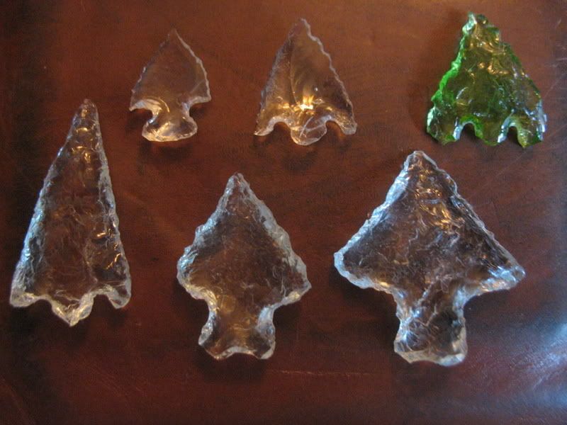

I made a green Mt Dew point that is curved like the shoulder of the bottle. Found the glass in the driveway of a shop I was working at and spent about 10 minutes making it. I also found some pieces of what appear to be shower door glass. Pretty thick and has a hammered texture on one side. It knaps FANTASTICALLY! The light blue ones are from that. The little ones are flakes I wasted time on and came out decent for flakes.
The large base tried to use was way too thick and I wasted a lot of material to get it to a point and even then it came out crooked and rough and way too thick. I have found it easier to toss out ones I break in the process.
I used an old cowboy gunbelt for a leather pad and it works great. Only bled on my pad once! Seriously, I think I have an addiction. They still aren't awesome and worthy of the Natives who inspired me, but everyone has to start somewhere.
