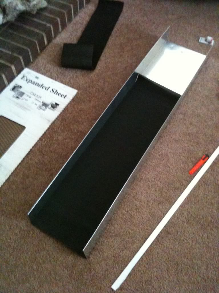

totally forgot my uncle does heating and air, he has a 10ft brake bender!!! so i bought a sheet today and got him to bend it for me, its going to be a 48" X 10" sluice, building it now, pics soon to come!
need some tips for riffles as I will be adding them to the expanded metal in the future. any ideas?? thanks in advance
Re: homemade sluice box

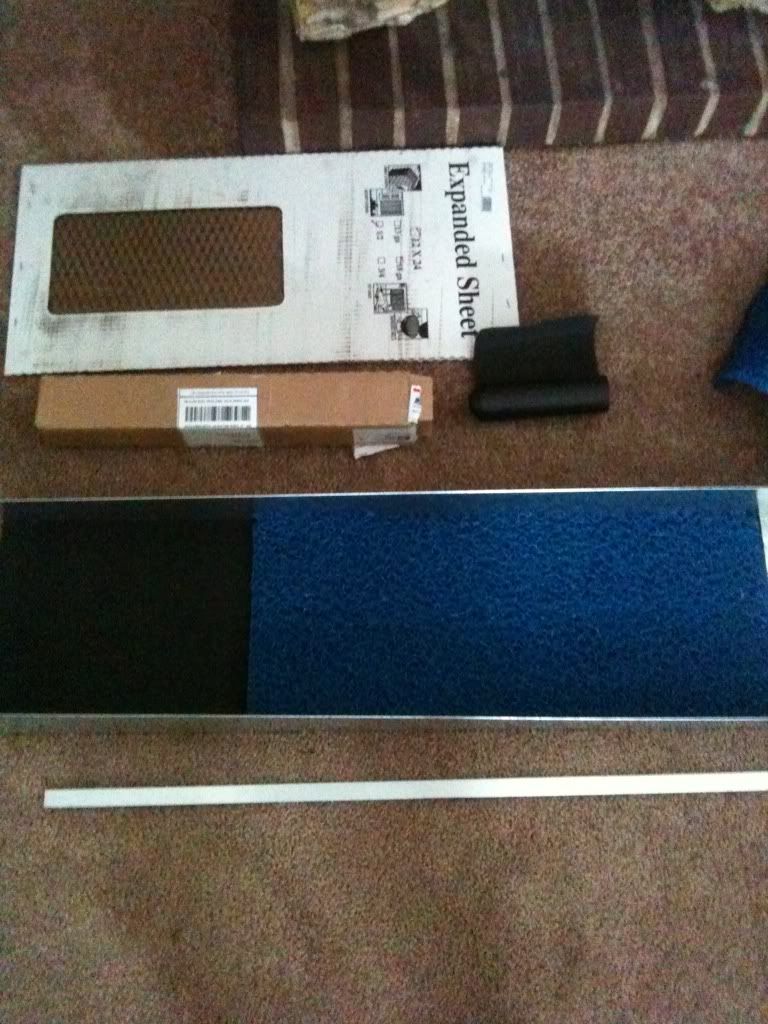

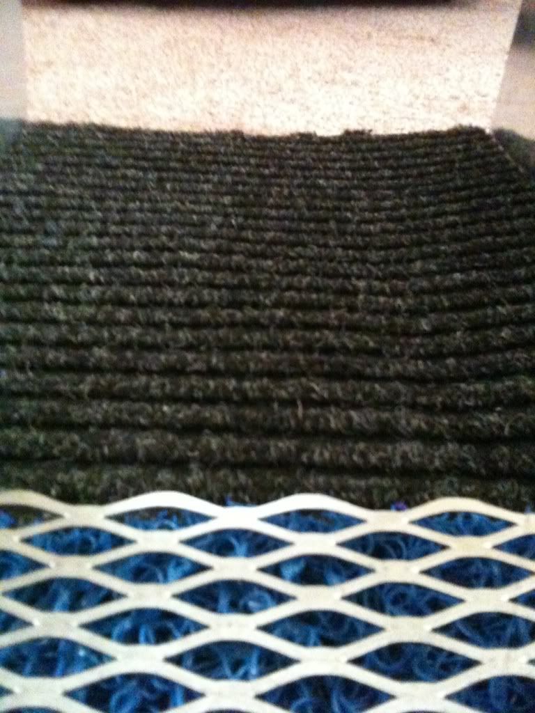

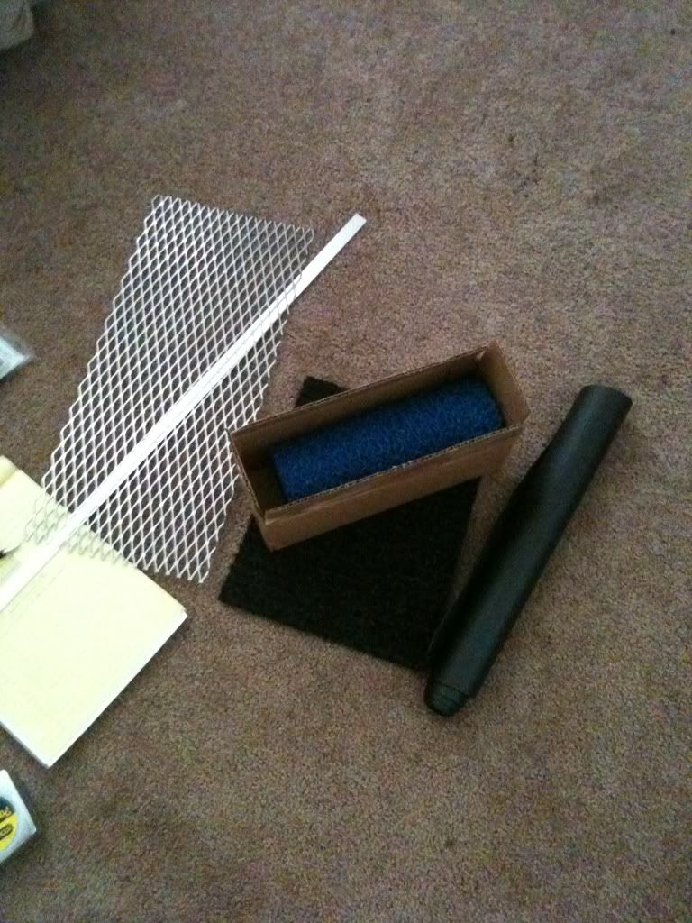

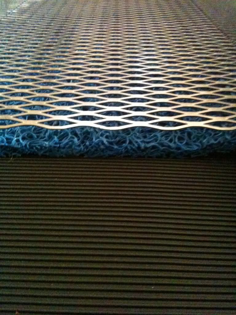

Status so far, just got everything fabbed up, nothing is secured just gonna look at it over the coming days on how to improve. A handle will be added to the side for ease of carrying.
Any advice would be nice.
Materials
Rubber mat cut (10" X 36")
Nomad cut (10" X 24")
Expanded Metal Cut ( 10" X 24" covering nomad)
Ribbed Carpet Mat cut ( 10" X 12")
I'm most likely going to glue the rubber matting to the sluice. It runs from beginning of sluice all the way to end of nomad/expanded metal. I am going to build a riffle/ramp from the rubber to the top of the expanded metal so I don't get any blockage there. I may come back and weld riffles to the expanded metal. Still got a ways to go as far as bracing, riffles, flare, and finish up. I'll update with pics as progress continues. Any ideas or changes u fellas would make? Thanks!
I wouldn't weld the riffles to the expanded due to air gaps between the riffles and the carpet. Have your uncle bend your riffle's on his break. I would build all pieces separately so you can disassemble for cleanup. Good luck....
i welded my "raised" expanded to the bottom of my riffels so that it all is bottomed out when clamped down. i wouldnt glue the carpet down.youll never get it cleaned out if you do! otherwise your doing good!

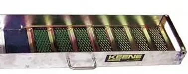

Ight guys, I'm stuck. I need your help designing a riffle tray. I just realized the expanded metal I got is not 4# it's just flat so I want to do a riffle tray for now then come back and add 4# expanded. What should I use for the ruffles and how do I build the tray? I would like to duplicate the Keene a52 riffle tray setup. What parts are required for this?
since my width is the exact same as the keene a52 and my length is only 3" shorter I think I'm going to buy the keene a52 riffle tray. I found them from a dealer for 39.99, not a bad price. that way I wont have to hunt down the parts, figure out how to pivot the riffle tray, hunt down a welder and hope they are welded on perfectly straight. seems like a no-brainer to me!
