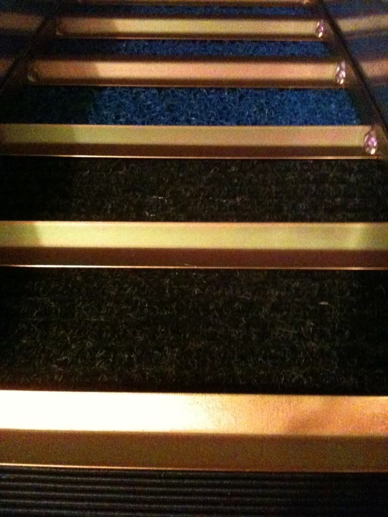

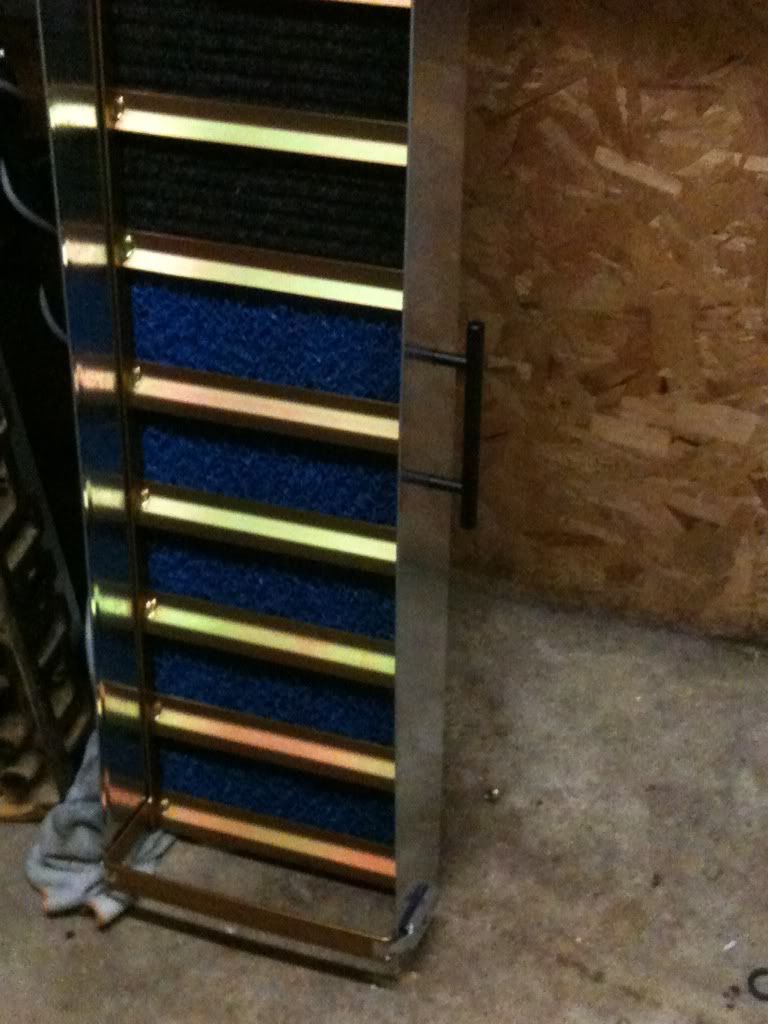

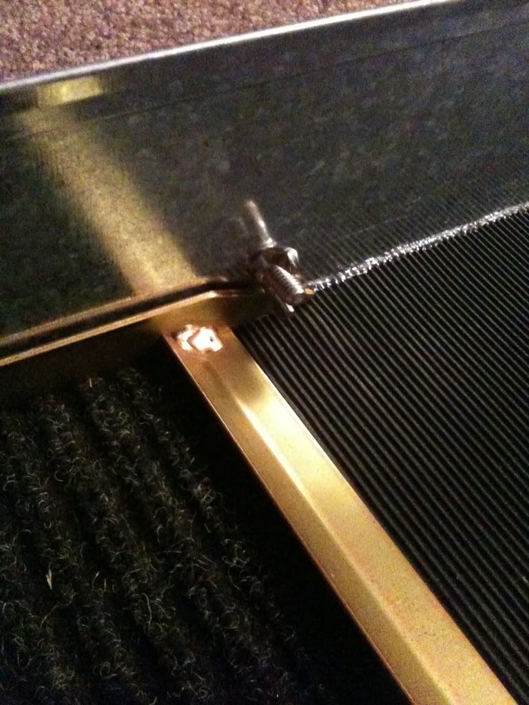

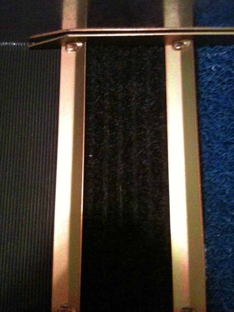

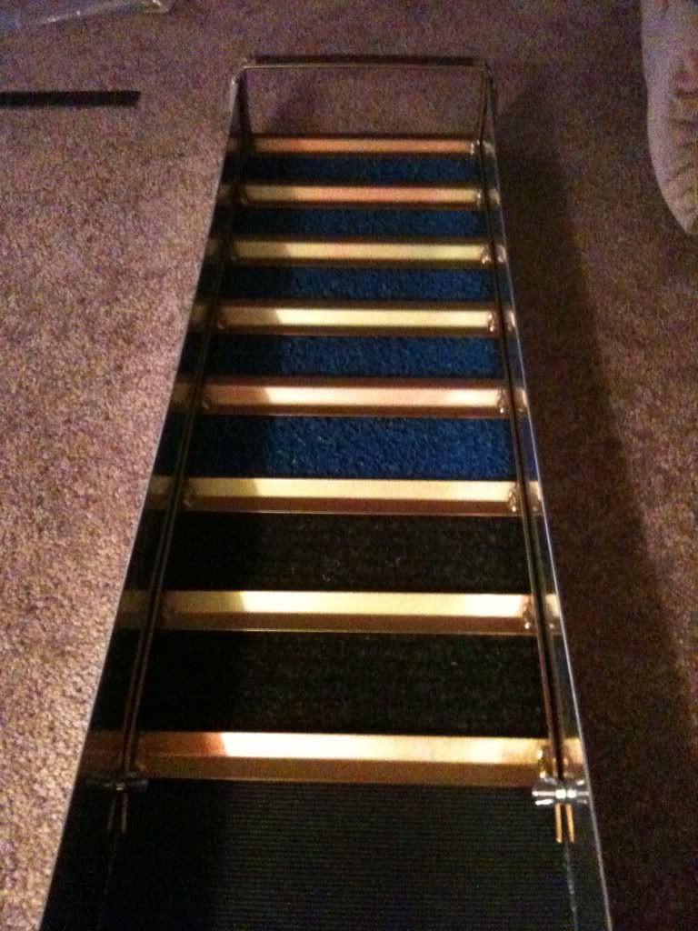

gotten a little work done on the sluice, just gotta order the riffle tray hold-down clamps from keene or anyone that has some and install the nuts/bolts to hold the front of the tray down! Parts so far are miners moss, outdoor carpet (this seems to be a little different than the green carpet that comes in the Keene sluices, my black carpet is very similar to drop riffles! any ideas as to how this will perform compared to the green flat carpet? im thinking it will out-perform it!) ideas welcome please give me some tips as the gold I will be finding will be mostly very fine in the 18-50 mesh range most of it in the 30 range! I'm thinking I may extend my carpet to the next set of riffles or do you guys think the miners moss will work as good or better than carpet? Add expanded metal? If so what size do you guys recommend? Enough with my rant heres the pictures!

also, are the riffles I have pictured regular sluice riffles or are they the dredging riffles? I'm a bit confused now that I have seen another thread on the forum
Re: homemade sluice box
This type of riffle and lay out would be more common in dredge, will work good in sluice also. I would be putting in a couple of extra riffles to vary gap in between - holds more fines though. Nuggy
thanks! so I guess keene sent me the dredging riffles instead of the regular keene a52 riffles! that sucks! thanks for the advice! Only way I can add riffles is with some sort of a riffle tray, may need to get in touch with heckler fabrication. any tips on material im using? haven't noticed anyone using the same style carpet I have pictured
Mat and carpet should work ok - just try and set sluice at about 12 degrees of fall when using - also classifying your material will aid fine gold recovery. Nuggy
Those are keene sluice riffles. The Dredge riffles are all the same heighth (3/4" I believe.) those riffles will work just fine.

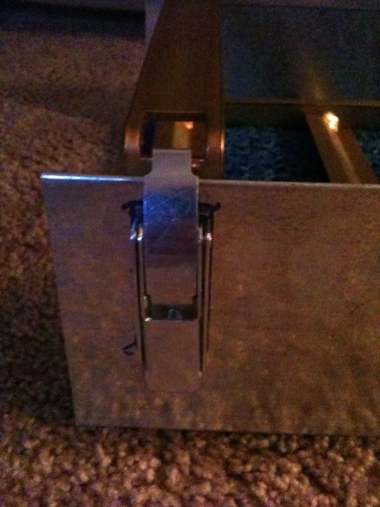

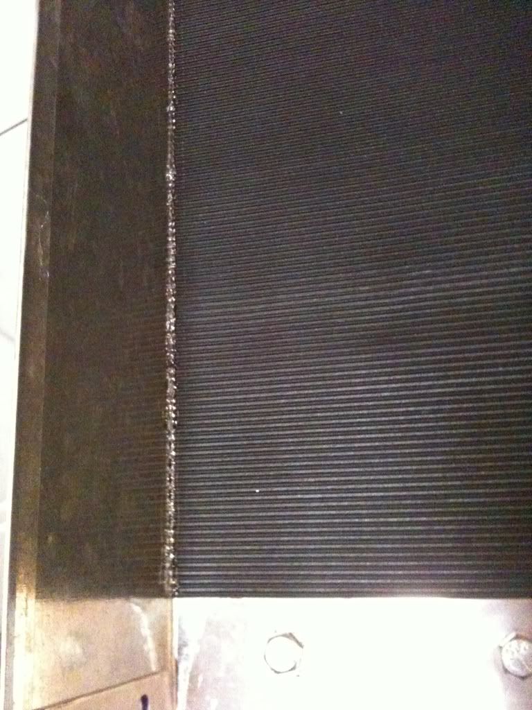

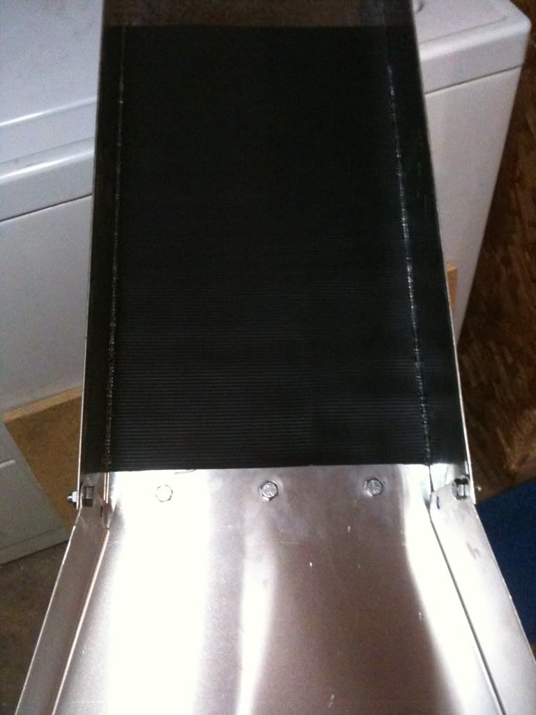

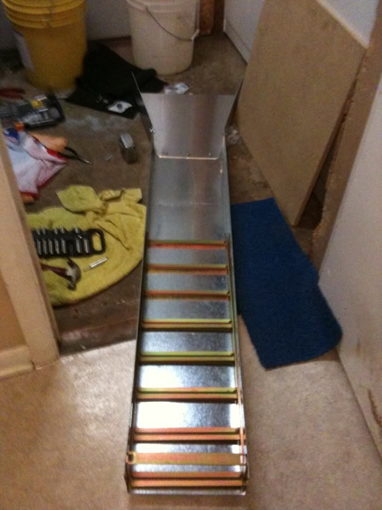

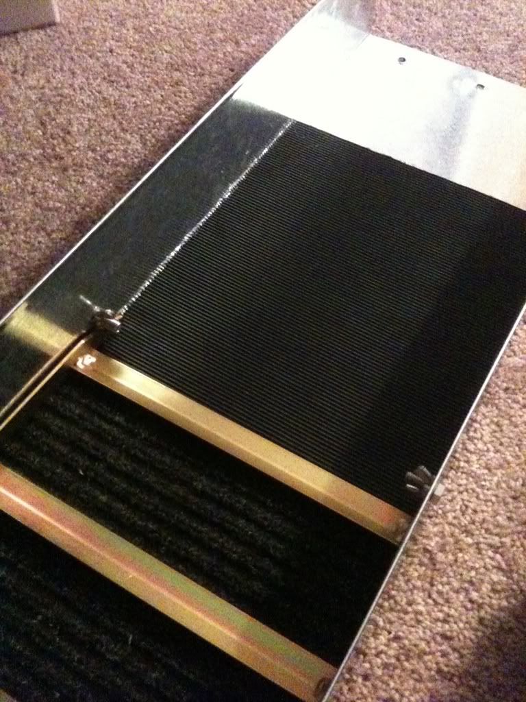

FINISHED! Finally! I'm going to experiment with different materials in my sluice but its ready to run as is and should do pretty good with small gold! The pictures do not include the 18" Keene flare that bolts on, without the flare the sluice measures 10"X48" so its a big sluice with the flare attached. I cut back the ribbed matting to give the material even more time to break apart and get that gold out of suspension before it hits the matting/riffles. I also extended the length of the carpet past the second riffle. What you guys think?!
I think it looks great for your first sluice man. Much better then my first one, for sure. One thing you should check is shine a flashlight in front of the riffles and make sure no lights coming through underneath them, as fine gold will work its way out if it is.
