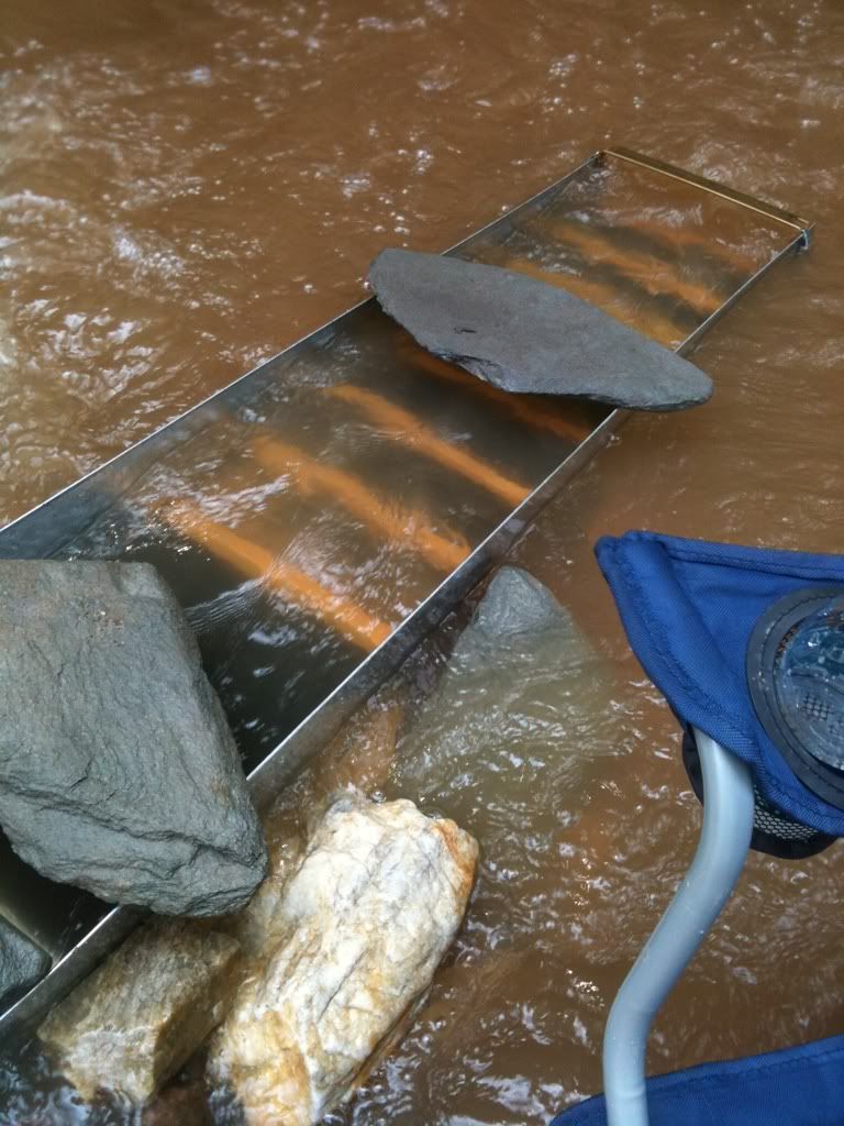

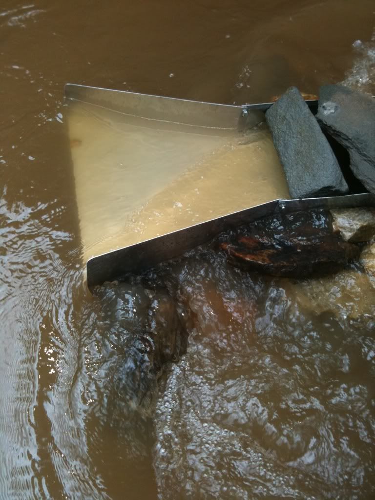

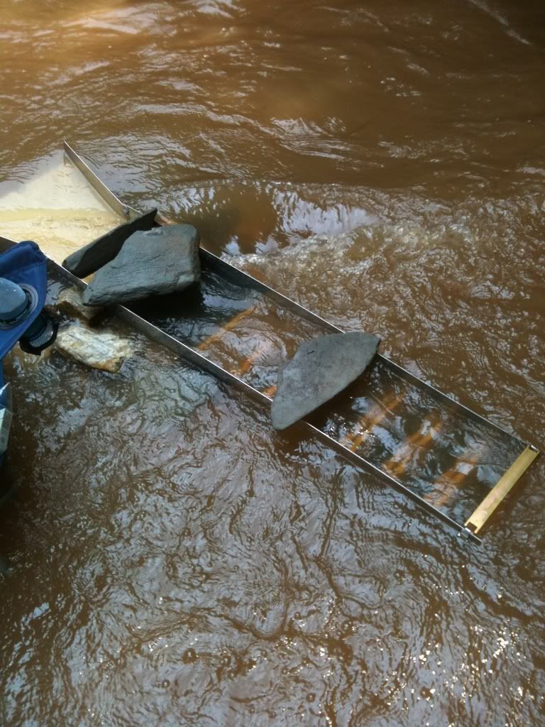

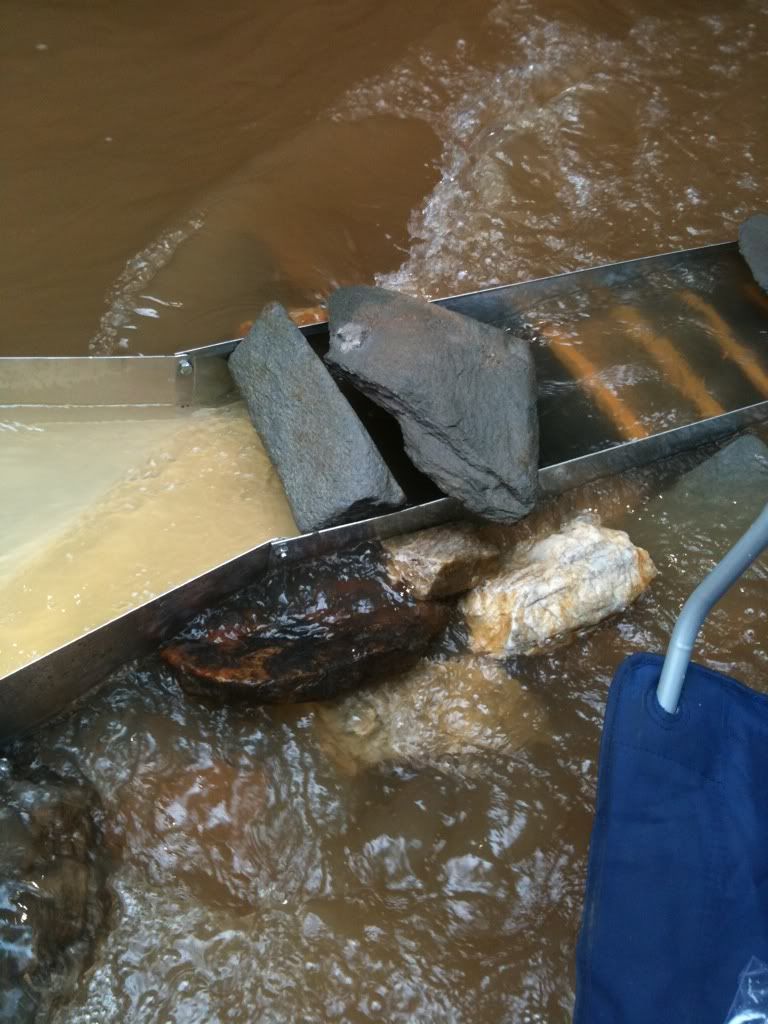

heres some pics of the sluice in operation, it performed flawlessly! only improvements need to be bracing due to being such a thin guage of sheet metal, or I can come back and just bend another sheet of thicker guage, it caught some VERY FINE gold! I was very pleased with its performance! I'll post pics of the micron gold it caught later!
I'm working with HoserJohn on a new matting to run in the sluice, hopefully we can come up with something that will catch even more gold!
