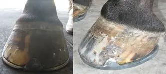

It's called a "bar" shoe on account of the bar across the heels. Bar shoes are used usually when there is a need to correct something wrong with the horses' foot, like contracted heels or the hoof wall is broken up and the shoer can only get a few good sound nails on one side. That condition usually has a clip or two drawn up the hoof wall to help hold the shoe in place also.
These are toe clips.
