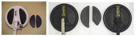

Oh yeah, is there a solid coil cover made for the Minelab's to put on the coil to make it closed versus open?

Sunray used to make plugs for the early stock coils but I don't believe they stuck with the idea.

The Sunray coil plugs DO work very well on the Minelab in the woods. The open parts of the coil are mainly what is making it snag things. I have found that the plugs need to be glued in or they will pop out during heavy use. I always carry a pair of pruners in the woods for use when I find a hot spot. I feel that going to a smaller coil in most situations for woods hunting is really counter productive because of the loss of depth. Yes, the electromagnetic field from the coil goes right through the leaves and forest litter. You do of course lose that corresponding depth into the soil. Joe
