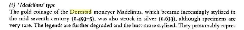

Yes I think so too. I have read in the book "Charlemagne empire and society By Joanna Story" that because the gold coinage in that period became more and more debased on gold, and that the gold coinage was also struk in silver, see text.
I really don't know, it would have to be cleaned first before grading, and I always read that a coin is more valuable if its NOT cleaned. Than kind of holds me back...
Thanks for your comment.

No they are not, a lot were debased, hence the different colours. :icon_thumleft:
