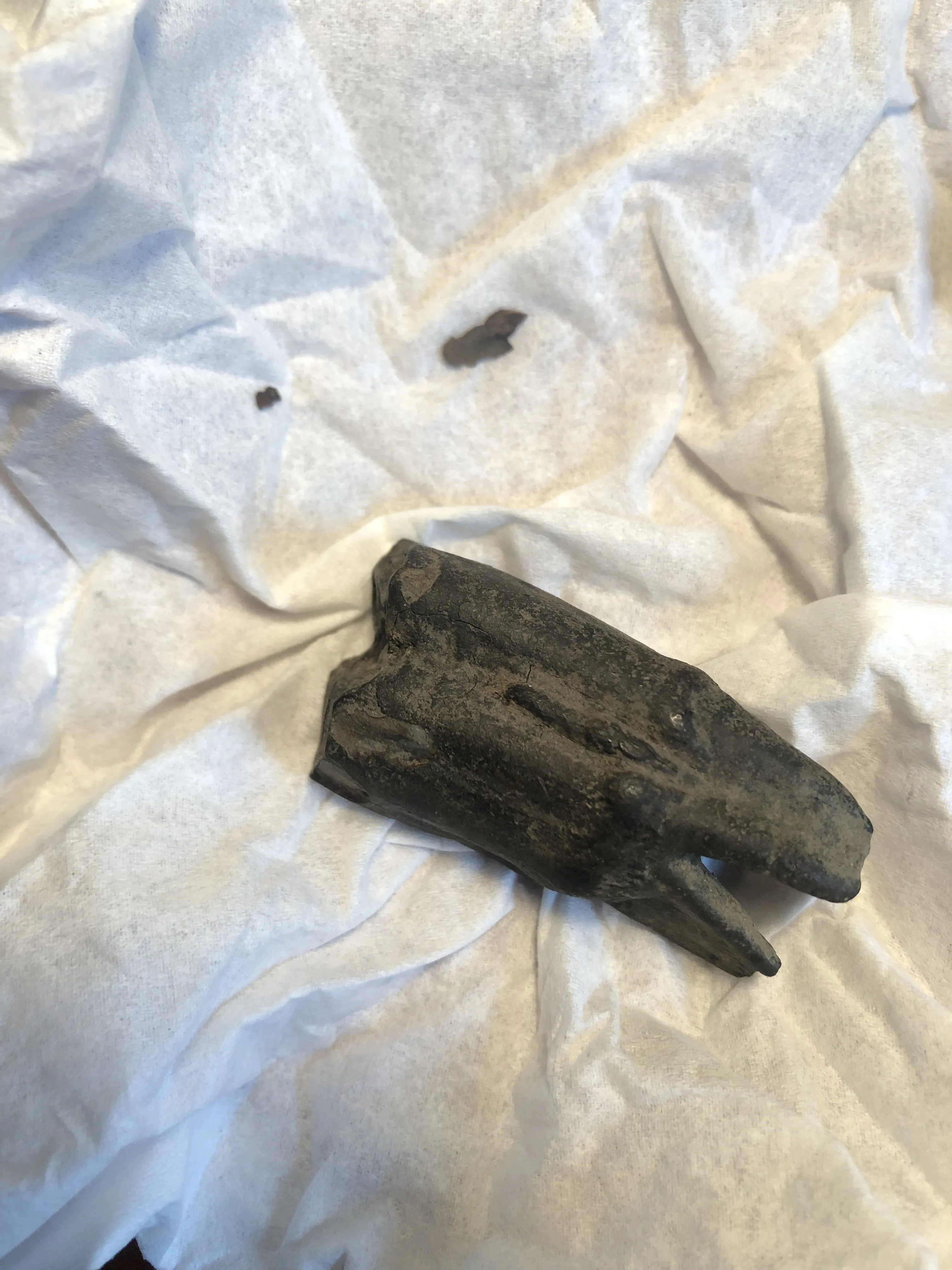

I found a fossilized bovine tooth while creek walking several months back. While it seemed stable at first, it now has begun to develop some fine cracks in the mineralized enamel, and one small flake has already come off.
I was hoping to learn the optimal way to stabilize a fossil like this. What would you all treat it with?
I attached a photo if it helps.
Thanks!
Until a member pipes in - search Google with "stabilize a fossil" (in quotes) in the search field. You will get a bunch of hits (including Vid's) with recommendations...
I suggest a mixture of White Elmers Glue mixed with equal amounts of water. Some people use glue 1:5 with water. Clean the fossil well before applying. Apply to the fossil while still wet. This is not a professional museum quality material to use, but your fossil is not rare or very valuable.
