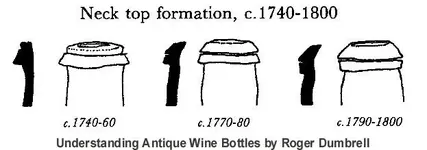

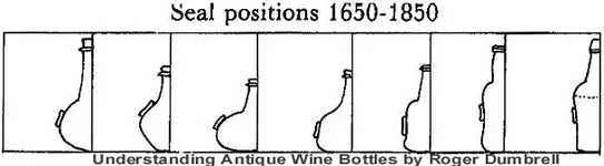

I think it may be older . England had seal bottles in the 1700s . this was a rich mans personal bottle . made closer to 1790s.

It could be older than the 1850s . . . I thought I saw a 3-piece mold seam, but maybe not. If landmagnet will provide us with a better description of the bottle -- with an image of the lip finish -- we can be more certain about a date.
bottle_seals.webp​
It does look like a 3-piece-mold.
Corton is more than an area of Burgundy. "Corton" is also used as a varietal name for wine from that limited area of Burgundy. I think the Englishman who had the bottle produced wanted to identify the contents. It may have been a bit of a brag because Corton was limited in availability.
This post is a good lesson for me on the importance of the lip finish in dating a bottle.
