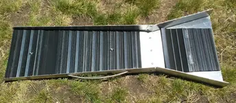

I have been wanting to get a sluice with Gold Hog Mats and I came across this beauty. I couldn't pass it up. I am hoping it is something that will augment my other sluice which is a Bazooka Gold Trap sniper 24". I started getting interested in sluicing this year and I really enjoy it. The Bazooka sniper I have is so easy and really goes through the material fast. I watch the tailings flow out and shovel at a moderate speed it seems. And it seems to be able to catch really fine powder gold. After reading here about the Hog mats I thought I could use this in a similar fashion and not classify. I think I can even run this in slower water than the Sniper likes but would rather be in water that I can use to process. I bought this because I saw this and I couldn't pass it up as it seemed just right for what I was hoping to accomplish. However, I am new and really don't know if I am correct in my thinking. I will run this soon to really find out. I would like to have some advice and feed back. It has Yukon in the first couple inches, then Razor Back and Downdraft alternating all the way down. It is 2" wider at the bottom than at the top and the sides become shorter toward the bottom. I guess the width lets the water slow down for better fine gold recovery. But, I don't know why it would be made with sides that become shorter toward the bottom unless it was just a result of manufacturing a rectangle sheet of aluminium. So, I have some concentrates that I'm drying out and will process them soon. I know there was gold there but not sure if I was running things at the optimum. This pic is the first time I set it in. I have made some legs out of PVC that I think are unique and will post next time I get it in the river. Hopefully soon and with a little advice from my friends here! I wouldn't be doing as well as I am already if it wasn't for the great articles here! Here's my new sluice. 0516171659b.webp

Thanks guys! I knew I could find out more. For some reason it makes sense to me now. I needed shallower water and more angle. I'll put my DIY pvc sluice stand on it next time and dial it in! I'm trying for -100 and -50 gold where I was. The 24" Bazooka sniper caught a good bit and I think the mats can grab that maybe better. We shall see. Thanks!
thanks forthe advice, it works fantastic now!
Thanks for all the advice about the mats. I took out the Yukon at the top and had a bit of downdraft I trimmed that had the perfect slope to tuck under the metal at the top. I flattened the metal riffle that was acting like a dam. Now material flows nicely and it works great! Thanks to the advice here! I was pretty dissapointed last time. This was my second time out. I had my new sluice standand it works great too! My bucket classifier moved lots of material fast. I couldnt have used my 24" bazooka sniper because of the clay. This was the ticket!! I only had pne clean out the whole day and had a half a cup of concentrates. I an very happy with this set up. Here's some pics of my set upnaw and the days take!!4.webp1.webp2.webp6.webp7.webp5.webp10.webpSluicemat.webp

Thanks mpgken, I would like to try some of that bed rock. but, this setup catches all of it before it gets to the end. nothing in the bottom area almost all in the first 3 mats. I bought this witth the Yukon put in place in the sluice. I didn't put this together. Plus to get the metal flashing over the Yukon they had this big ramp that acted like a dam. Now it runs smooth and no riffle in the beginning. Thanks, I went to the GH website many times and that is why I bought this sluice, it seemed to have what is recommended for a stream sluice for fine gold. I am very happy as I believe it catches all the gold. And with my leg setup I can adjust the level and hight easy. It is now fun and working like it should. It's my second time and I am studying how to find the layers where the gold is. I know now that some was in the muck and clay, but most next to the bed rock. I'll be hand dredging into this sluice next time and getting the bed rock material. I can't wait...It's exciting to see this much color. I haven't found that much ever. I did work hard to get it but it was fun!
Mpgken, I like the idea of the bedrock. I thought it had to be tuned or run fast. I may want to make another set of mats for ripping water. So , I'm beginning to think about a design for mats for this sluice. I may go to th GH site and see if I can find put a little more about what I can do....I Like this sluice as I can customize it! :icon_thumright:

Hey Guys, all good advice! Thanks! I have Razor back, downdraft, razorback, downdraft, razorback. That is basically the low flow/medium flow middle part of the GH stream sluice and what Doc seems to think are the two best low flow mats. I can only fit 5 sections in the sluice at a time so maybe I could try some talon on the top followed by some bedrock for a little faster water. Both those mats require faster water than razorback and downdraft and since this sluice gets wider towards the bottom the flow becomes shallower and is nice for the razorback and downdraft mats. I can see how increasing flow could move more material. I was shoveling from the bank directly and just washing off the big rocks and throwing them onto the dam. It really did fine. But, when I was diggin in the middle of the stream I ran into clay and it was thick with black sand. That was why I began classifying to break that stuff up. It was fast with this bucket classifyer. 2-3 full shovels, swish it knead the clay a little. I went through more material than the guys with riffle sluices for sure. There wasn't enough slope to get the sluice much incline, so I was dealing with that by building the dam on the side. The middle was over 3' deep. I'm thinking the clay had only a little gold compared to the looser gravels below that. Next time I'm using a hand dredge to vacuum up the bottom. The legs slide through those fittings. They are pretty tight and move by twisting and pulling/pushing. They work great! Wow, a gram and a half of gold at the bear is nice! I'll increase my flow so the fine gold moves more toward the upper middle. It makes sense that I should watch where the gold is being captured and less about the black sand and gravel. I could move more material that way and am confident now that if the gold gets in this box it's not leaving. I ran it all day and TRIED to blow gold out and only one clean out at the end. I kept seeing the same flakes just stiitng in the same groves and the gravels were exchanging out. I'm a happy camper. The mats in it right now I think are the best for this spot but I think I could just use tape to connect the mats to swap out and use talon and bedrock when I find faster water. I see Doc using bedrock at the end but its rated as a medium flow so mine has faster flow up top. I see UR being used too. I just am thinking the shape of my sluice varies the flow so the mats are being exposed to different flows down the length. Bottom line is kind of what Kevin in Colorado said about moving as much material as possible and knowing the gold (not the gravel) is staying in the box. I can't switch mat sections to different positions because of the shape of my sluice. I could cut sections for the lower area and experiment! I like having this ability to switch things up for the right water flow. I am super confident I can shovel straight in like a mad dog and it will do it's job. With the correct mats, for the flow conditionsthis will let rocks roll through even with the conditions you see my sluice has. I didn't have ripping fast water and I could shovel straight in and hand pick the really big rocks out like what we do with the bazooka gold traps. I felt like these two methods were comparable in speed. I still am eying the Grizzley Gold trap Motherload! But, for now, I think my production with this mat sluice is higher than my 24" bazooka sniper. But for hiking and the production the sniper gets, it's a great back packing solution. Can't wait to go out again and get some more experience with this mat sluice! Shovel more, get more right?
I went to look at some of the other mats to see if there is something I could use to improve efficiency. I seem to need pretty good flow on the top third as the rest slows because of the shape. I just seem to think my first two mats would go bare too fast. I got some talon mat. It can handle the initial heavy material load and high water flow. I'm hopeing with two talons then razorback, downdraft,razorback, I can have the whole sluice activly working the load properly. It's a challenge as the widening seems to effectively create a varying flow as maybe a longer sluice might have. I either had my first two mats blow out or my last two mats load up. It may have worked better if I had a little more incline. Well, I ordered the Talon so now I can have some mats to put in for faster water and keep the current mats for slow water. I liked how the talon mat worked. It has lots of vortex action. Looking forward to getting it and going out with a hand dredge too. I think this is my dream set up! At anyrate, I have a sluice that is customizable and thats part of the fun! Thanks all! I'm grateful as I never would have gotten this far by myself. Already I have found more than I thought I would. And I got a little fun in the sun!

The Eagle has landed! I put 2 Talon mats in at the top. That Talon looks perfect! The scrubber mat has a high ramp and I already had problems as the original build had a similar ramp that inhibited flow too much. This Talon has some very interesting properties. It's vortexs draw the gold down and actually up hill and into the lower corner very aggressivly. I know this mat up top is the right choice. Doc recomends Talon or Scrubber up top and UR. So, now the sluice should be effective top to bottom with great production in stout water flow. I have taped the Razor back and Downdraft section and held it down with a wing nut and kept the Talon separate but taped and held down with another wing nut. Now, I have 2 different top mats to choose. Plus, it makes it easy to clean just half at a time! I cant wait. I am just taping the sections together so I am able to swap out Razorback and Downdraft when the waterfliw dictates... Thanks to you all here I am making significant prodress and doing so much better at production I'm totally amazed. Here's my "convertible" sluice...

I can see how it could be confusing. I only placed the old mats in the flair for the photo to show them as extras. I don't leave them there. I can place them back for low flow if I need to. Thats why I'm saying it's a convertable. I can now swap the top mats by losing 2 wing nuts and slipping them together. This sluice now has 2 talon mats up top replacing those old mats. I have a couple of inches of downdraft right against the flair tucked below some metal flashing making a smooth transition onto the mat bed. I can deffinitly see gold get caught there like you described. I can see when I'm on the gold pretty easy like you described. I can't wait to see how well this works! I like the idea of the ribbed mat for testing. I'll have to give it a try thx!
The test went better than expected! I was shoveling material with rocks up to 3" and just hand picking the bigger ones as I worked. I got in a spot 20 feet away from the last and in the middle of the stream. I got about 4 grains of +20 flakes and hardly anything smaller. I did have amounts of -50 and -100 black and blond sand. There was about 5 tablespoons of that small sand. However, this time I had very little gold in that small size. The sluice was doing everything great. The Talon was doing a fantastic job of incremental processing and areas cleared out while a row stayed holding gravels. That's a real work of hydrologic wonder that mat. That allowed me to use higher flow up top and when material reached the bottom the water was ripping at about a half inch. The Razorback and downd draft sections kept a line of gravel where they should and cleared out where they should. I can shovel fast as I want. Dug a big ole hole in one day. I am very very happy! Now I have a production sluice! I have one question. Since I got plenty of very small -50 and -100 sands, shouldn't there be gold that size as well? Maybe where I was had mostly bigger gold? I would think if I caught small sand small gold would be there. 20' away and higher up the bank There's lots of the small stuff. This gold had mercury and I had bits of white colored lead. I am going to go back out in a week and shovel more into this beast! I really think this sluice is processing well from top to bottom. Anyone else with a sluice shaped like this may want to try the mat configuration of what this has now. Talon-Talon-Razorback-Downdraft-Razorback.

This box is narrow at the top and widens by 2" at the bottom. So, I can't change the order of the mats. Also, the issues I was having were due to the box shape. I had to send a pretty good volume of water through the top to make the bottom have the right flow. The two sections of Talon at the top do a great job of incremental processing a full shovel of dirt and the bottom 3 mats seem to be catching the light thin paper like flakes of gold. Now the top isn't blowing out and neither is the bottom portion. I had razor back and down draft up top already and replaced with Talon as the strong flow was blowing out the top 2 mats. I think this now has the correct combo for this unusual shaped sluice.
