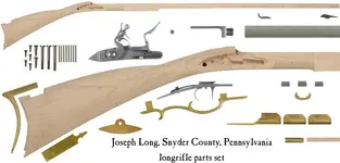

Here's a picture of a long rifle kit. Note the tabs on the trigger guard, and also on the ramrod entry thimble and the ramrod pipes. You can't see the tabs that pin the barrel to the stock very well, but there three of them above the ramrod pipes, and you file a dove tail into the barrel to install them, then the stock is drilled with the hole going through the tab, and an iron or steel pin goes through the wood and the lug to attach the barrel. Keep in mind that there is a groove for the ramrod, so there is a very narrow bit of wood that has to be lined up and drilled through. If you aren't careful the ramrod channel could be blocked. Keep in mind that the ramrod enters the stock and the hole goes clear to the breech plug, and it has to go between the bottom of the lock and the top of the lug on the trigger guard. Kind of tricky, but ends up a beautiful rifle.

I edited my post and added more information. Not a pain in the butt Red, there is no place to use a screw on some of those old guns guns, tolerances are so close it would interfere with at least the ramrod. Never used a brass pin, even on a silver inlay, it was pinned with an iron pin, and they pinned a lot of decorations and other stuff. They also used pins because every screw was filed by hand, one at a time, and never from brass. If you see a muzzle loader with brass screws, it's a repo, no original had them.
Ive always dealt with percussion,never flintlock guns.I was into the Hawken style rifles.They were alot more basic than the Kentucky,Pennsylvania,long rifles.The ramrod holders were dovetailed into the barrel or a small hole was drilled through the holder and screwed to the barrel.The trigger guard was simply a screw on each end,the front screw usually going to the breech plug where it attached to the stock.
