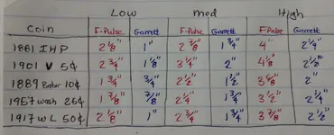

These are the numbers I got air testing the F-Pulse against the carrot. I've only been out with it once and was very impressed with is ability to pinpoint multiple targets in the same hole. HH
