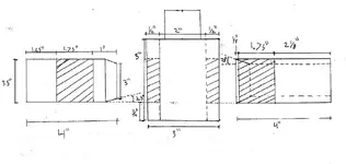

Thanks for the advice guys. I'll be picking up some real dredging hose as soon as I can. But I've ended up building a couple jet that I'm going to be testing later today.
Here's some pics let me know what you think:

I went out and tested it a couple hours ago and it seems like it's a ton better than the power jet. Although I don't have an accurate comparison because I just used 4ft of PVC pipe as my hose (the pipe I used for the inside was schedule 80 so the O.D. is 3.5" and to big for my crappy corrugated hose). I'll be testing it on the actual dredge at Quartzville creek tomorrow and also ordering some dredging hose. Does $5.00 per ft sound like an O.K. price for 3" hose?

Just tested out my couple jet with the full set up and it works 3 times as good. Although unfortunately the hose that connects the pump and the couple jet keeps on shooting off like a rocket every now and then. Thanks again for the help.
Double clamp the hose and open up the jet a single turn to allow a bit more water into the flow and then you can turn down your pump a little too with the same results. Alfonso at Gold Divers was 1 smart fella and his jets SUCK!!!!!!!! :laughing7: For the best induction angle check your taper to see if between 11-13 degrees too for a bit more efficent push also. John
that couple jet looks cool. really neat design . definitely thinking outside the box . i would like to build one of those . post specs please .
For 17% more psi and much easier flow cut the inlet to the same degree angle of the pipe roundness / as trying to introduce water straight onto the pipe is a restriction-same as any 90 degree bend just kills your stats too-then you can even run your engine slower with better suction also---every little bit adds up to end up with a HUGE difference :headbang: John
Here's the plans:
The pieces on the left and right are made out of schedule 80 pipe. The two half inch sections on the middle piece is just half inch plate steel (I used galvanized because it was on hand) and the outside shell is 5" truck exhaust pipe. Where ever you see diagonal lines they just represent 12 TPI threads. Also on the inside of the middle piece i covered with a layer of silicon glue stuff as a sealant so I didn't have to weld the entire seam on the outside and possibly deform the threads.
If you want to make it this exact way then you're going to need a lathe that can thread, but if you don't care about adjust ability then you can weld the two pipes in place and potentially not even have to use a lathe. However a little bit of math will be needed to match the gap between the pipes to your pumps specs.
