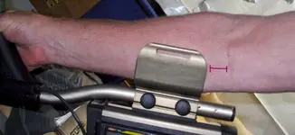

Once assembled, I picked it up to see how it felt in-hand, and I immediately
noticed how the forearm cuff was scraping against the inside arm of my elbow.
I re-adjusted the cuff to the most forward position, and after checking again
the edge of the cuff was still too far from the grip to be comfortable swinging
it:
This is probably no big issue for 90% of the users, but unfortunately I was
not blessed with long arms..:dontknow:

My solution was one of two things: A) Request that Nokta send me a new S-shaft
that has a 5th hole so I can move the cuff mount more forward; or B) simply add the
hole myself. I chose "B", as it's pretty hard to screw up drilling a hole when you have
a template mounted to the shaft.
Had to check first to make sure there was clearance for the control box, and did find
that it was right up against the shaft, but just barely. Mounted the cuff using the back
hole, and then just drilled through the shaft.
Note in the results pic, below, that the cuff is now forward enough to be comfortable
swinging it all day.

Hope you all understand that in no way am I saying there is a defect in the
design, I moved the cuff forward to accommodate my own wishes. Also,

Nice mod!
My forearm is too large to fit in the strap so I just use the strap as a pad and let my arm sit ontop of it.
I never noticed the problem because of how I use it, but when I was setting it up I did move it furthest forward because I felt that it was too far back.

Nice mod!
and let my arm sit ontop of it. I never noticed the problem because of how
