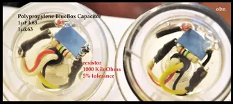

With the new Excalibur II's....there are now three wires and where the cable goes into the control pod there is a resistor and a small blue either IC or connector. I also notice that there is a capacitor that has the shielding wire attached to it on the control board.
I assume that the resistor is to match impedance. I know the Grey Ghosts have a method of switching wires to make the headphones work with any detector. Using the alkaline battery caps, should I just not worry about the resistor and the little blue box in the original control pod end where the headphone cable enters which would no longer be there if I used the alkaline battery caps?

Steve have not traced the ground on the excal II's, It is there for a reason but I do know it has nothing to do with the shielding on the new excaliburs II Pod. The resistor and connecting Capacitor are High pass low stop audio filter, Its a capacitor and a resister , It lets the high frequency audio pass into the headphones with no reduction in volume while it attenuates (reduces the volume) of the lower frequency audio. Let us know which way you go, If it were me,.....I would make a set of head phone's from the Peltor's, cheaper and I would guess better then the GG......I have a parts list, and the good is you would not have to worry about the endcaps.
