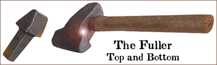

Here is another blacksmith's hammer. It is used to form hot steel into a square-ish shape.
What do you call them?
The only marking that I can read is "3/4".
THANKS IN ADVANCE!!!
Not a hammer, it's a swage. The bottom swage fits in the hardie hole in the anvil, and the handle of the top swage is held by an assistant opposite of the bottom swage, and the red hot iron is between the two. The smith hits the top swage with his hammer, making a square bar. There were also flatters and fullers that were used the same way, as well as hot chisels with handles that kind of look like hammers, but are held by an assistant and the smith cut the hot metal off by hitting the chisel. Here are a couple of pictures of tools that look like hammers but aren't.blacksmith tools.webp
This is a hot punch
1 punch.webpflatter.webpThis is a flatter.
round swage.webpThis is the base and the top round swage, and a finished hand forged handle showing what the smith did with the swage.
fullers.gifAnd this is a top and bottom fuller.
