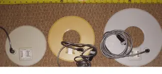

For those whose experience does not extend to the 7" coil manufactured by Tesoro for the Sand Shark, here is a picture of mine:
Shark coils.webp7", 8", 10.25"
View attachment 8010837", 8", 10.25"
