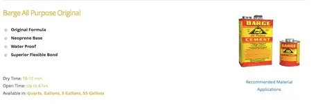

Barge Products - Barge Cement
Barge contact cement....... Be sure you have things lined up before touching parts together....
