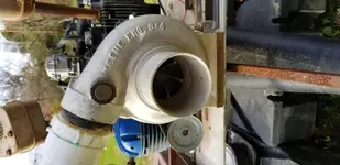

So last year i picked up a semi homebuilt 5 inch dredge for a steal. The frame and floats are garbage but the rest is all pretty much brand new keene parts.
I have been debating on selling the motor and pump because it is a briggs 18hp opposed twin and a keene p350s pedastal pump, which in my eyes is overkill for a 5 inch dredge at the depths i normally dredge at.
My question is if i ditch the huge 18 hp motor and hook the pedestal p350s to say a 6.5 hp engine that is modded and now producing about 10 hp, or a 8 hp engine will this work to power a 5 inch dredge, or even a 4 inch?
It may be that i just have to try it and see since its a rather odd engine/pump combo to dredge size match up.
Thanks for the input!

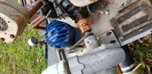

John - I think it is a p350s, cause someone before me wrote p350s on the pump with sharpie. So i may not be. I happen to have a 6.5 predator motor that has been modded to produce about 12 hp, so im going to get a lovejoy connection and mate the two up and see if it will power my 5 inch. Ill be sure to take video of it. Should be interesting.
If it doesnt work, ill sell the pedastal pump and buy a dahlke dp500 on a subaru 7 hp motor.
I think the issue you would have with using a smaller engine is that it would have a hard time staying in it’s optimal operating rpm range. If you are running at lower rpms then you arent hitting the peak power of the engine. They change the angle of the impeller blades to allow the different size engines to run optimally. Something that would likely work pretty well for you at a small cost is putting a belt drive on the pump and giving it an under drive, or gear ratio reduction. That would allow the engine to run at it’s best rpm range and the pump would put out about as much flow and pressure as it would with the proper impeller and a direct drive.

What is the difference between the 350 and 350S?
Keene Eng.
p350 is for 8 to 13 hp they also have 3 different bite impellers, one for 8hp, one for mid size(9hp) and one for 11hp+
P350S is for 18hp+ & P355S pedestal
PHP500 is for Honda GX390 (13hp)
P1500 is for 35HP+ (free standing needs coupling)
there is a difference between the P350 and P350S housing because they sell the two separately. (part #301 & #301S)
only way to tell is to have measurements when you ask Pat Keene
