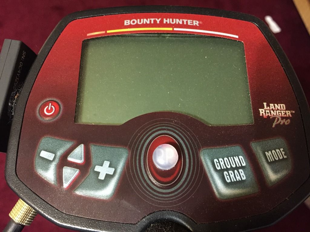

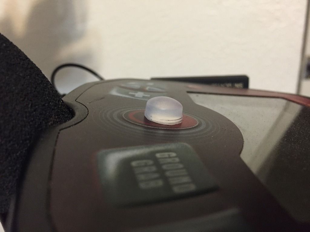

The pinpoint button on the monoplane face is quite touchy and doesn't take much to disengage. What has helped in the past is to buy stick on door pads small enough to place on the membrane just above the button. Here's a pic of what they look like with four clear ones on a sticky sheet. Just peel off an apply.
About a buck at WalMart. They should be the size of the raised membrane and no bigger. Smaller is OK. It makes for a better feel for maintaining proper pressure.

I have the same issue. I will have to try the rubber pads, thanks for the tip Phantasman:icon_thumright:
Pads really help.
I picked up some assorted pads or bumpers as the package says. They really help out.
Before I stuck one on, I used the handle of a small screw driver to see just how big the membrane switch really is. It seems to be about the size of the PP graphic and not the button outline. The sweet spot on mine is at the bottom of the PP graphic.
