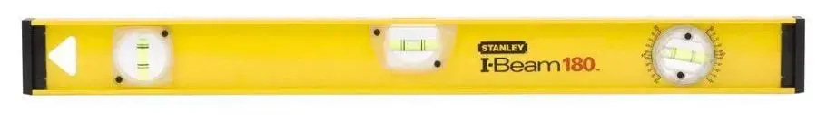

Found the tool made for the job. The Stanley I-Beam 180 at Home Depot. The bubble on the right can be set to whatever angle required.

the way carpenters would get a level to read 1" per a foot is to fasten a block to one end. Say you got a two foot level, A 1-1/2" block gets you 3/4" per a foot, cause you jacked up the one end of the level 3/4" per a foot over two feet. A two inch block gives you 1" per a foot, and a 2-1/2" block would give 1-1/4" drop per a foot, all while the vial reads level..
I learned that from a carpenter.

And then you have one of your partners that insisted that he wanted a drop of an inch per foot on his six foot sluice so I got my four foot level and gave it four inches but oh know...that won't work...we need a six foot level. Go figure. Retired carpenter here so I will give you a leveling tip that comes in handy when plumbing rough framing, etc. Tape a short (couple of inches) piece of 1X2 at the far ends. That way only the two small pieces and not the center touch your studs which sometimes can be really bowed. This gives you an accurate plum wall from top plate to bottom plate. Could be useful on long sluices also. I use this method constantly on my 80in. level. I don't have a set fall on my five inch..I go by how the riffles fill and what I'm suckin' and how fast I'm pumping. And also notice that there can be a big difference when empty vs. full of water and gravel on pontoons.

A person could also place a length of clear tubing from one side to the other on one side of the frame, fill it with antifreeze for color and to protect from freezing, cap it at both ends, and have a permanently attached water level. They are pretty accurate as well.

You could always just mount a bubble permantly to have a visual reference.
Or just keep a small torpedo level in your pack.
