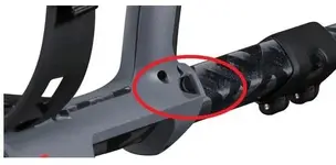

This week I found myself working my 3030 in some surf a bit larger than I was comfortable in. So as I was exiting the water, a large wave caught me on the back and down I went. My scoop was pointing toward the water but my detector, toward the sand. I put Way to much pressure on the shaft as I fell and the Upper Square Shaft (#76E002) snapped right at the handle housing junction.
Does anyone know a good source for these (Other than MineLab)? I'd like to get two. One for the replacement and one as a spare for my bag.

It broke right there,.....

Yep! Right at that junction, Sanman. I was on a trip in the Islands and luckily I'd packed the star bit that fit the housing screws. So as a Temp Fix, I just removed the section in the handle, then reinstalled the remaining shaft there. That puts the lower-shaft lock right up against the housing and losing about 10" of overall shaft length.
The OD of the shaft across the square is 1-1/16". It's real thin-wall material though. That's so the lower shaft can slide inside of it. The wall thickness is a fraction larger than 1/32". The lower round shaft OD is 1-3/32".

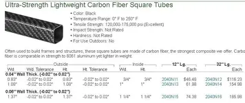

First check the Mcmaster carr book, (website).
https://www.mcmaster.com/square-tubing
Also I will try to sort out a source I used for carbon fiber tubing a few years ago.
Square makes it tougher, round tubing is easier to com by.
Give me a chance to think about this a bit.
