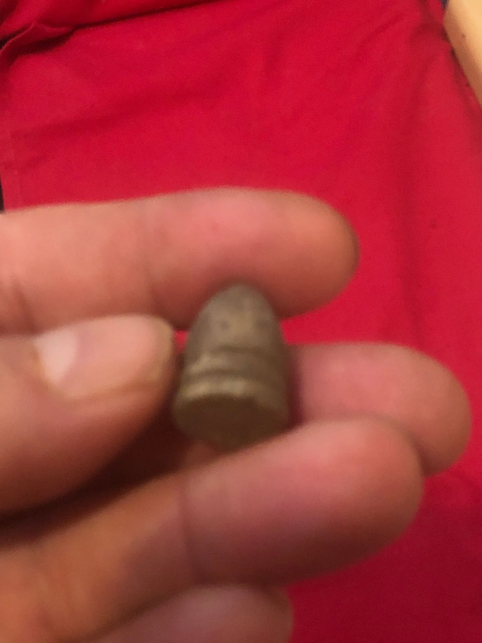

The a a Burnside bullet a a flattened Burnside cartridge. I need it opened up and set the bullet in the case to the original condition. Can anyone do that?

Can you post a pic of the cartridge ? show us how flat it is. You might be able to do it yourself.

That’s a good idea truth, post a picture if you can bud
Sorry I’ve been sick with this damn flu ugggh
Maybe if you can open the end of the cartridge just enough (with something like a standard screwdriver) To insert a tapered wooden dowel .You might be able to open it up the rest of the way by pounding the dowel end with a hammer. dunno.

Wow those are way flat, i am a metal worker, that is going to take a special touch to get them close to original state.
You know since I have 3 cartridges I might try it on one.
Man thats gonna be sketchy at best..
2 already appear to be real brittle, and have cracks.
if ya try it, go real slow, and take your time... use something soft like a plastic spudger maybe.
Truth, those are some cool looking Burnside casings. Best of luck to you.
Make an outside mold by drilling a hole the same size or smaller than your finish cartridge. This will support the sides of the shell and keep the metal from stretching too far.
After annealing the cartridge with a low flame propane torch, use a sharpened (with rounded end) hardwood dowel to reshape the cartridge. Good luck.
