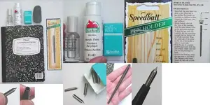

Materials Needed: These are obtainable at just about any art supply store, and can even be ordered on-line over the internet
1 Small calligraphy pen holder (Also termed a "quill" pen)
1 (or more, as these do tend to wear out) very fine calligraphy pen tip, also known as "nibs". I use a number 104, but don't take this as gospel truth, as other sizes may produce more favorable results for you.
1 small bottle of white acrylic WATER SOLUBLE paint
1 small bottle of clear nail polish
1 "composition" log book

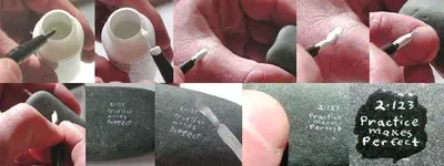

Before attempting to label a real artifact, you should locate a smooth-faced stone, which you can practice on. When you're comfortable that you're getting the desired results with your "practice stone" proceed with labeling the real artifacts in the following fashion. First identify side A and side B of the artifact. (Side A is the side you intend to show if the artifact was placed in a display case, while side B is the "less attractive" side of the artifact.) The label should be placed on side B. Locate a fairly flat section on side B for the label. Try to avoid ledges and hinges for the label area because ink which gets into these areas will be most difficult to remove. Choose the flattest area you can find. (Tip: If the artifact is broken, see if it's feasible to put the label on the broken edge, leaving both faces of the artifact "clean")
How To Use The Calligraphy Pen
First, press the pen tip into the pen's plastic body. Shake up the bottle of paint. Dip the tip of the pen into the paint far enough to fill the pen tip's "reservoir". There are a couple of tricks I use before actually trying to label the artifact. Normally, the very first stroke from a freshly loaded pen tip comes out too thick, whereas the second stroke is usually much finer and gives much more desirable results, so, while holding the artifact between my thumb and index finger, I "dab" the entire bottom of the pen tip's reservoir on the base of my thumb, then I dip the very tip of the pen into the ink on the base of my thumb and I then touch the very tip of the pen to my thumbnail to "prime" the flowing of the ink from the pen's tip. Then I gently touch the tip of the pen to the artifact to draw-out a bead of ink. The pen should not actually touch the artifact, but ideally one should let the ink/paint be "drawn" from the pen tip onto the surface of the artifact with each stroke. (This DOES take some practice !) Once the label is completed, let the paint dry for 3 to 5 minutes, then cover the label with a thin layer of clear nail polish so that the label is "water proof".

If you've used the proper type of water soluble ink (paint), nail polish remover on a Q-Tip should remove the label completely and without a trace. BE SURE to try this on your "Practice stone", to verify that you're using the proper materials ! Also, while labeling an artifact, if you're not happy with the results, use a damp cloth to erase the label and try again.
