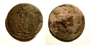

Coins before cleaning were humidified in the distilled water. (I recommend all copper coins found in the earth to keep in a hover at least days in the distilled water. It promotes removal from a patina of salts and alkali which destroy a patina and a coin.)
Coins were cleaned by the self-made shaber made of a sewing pricker. After cleaning of coins and polishing by a ball shaber, put a patina with sulfuric ointment. In Russia she can be bought from us in any drugstore. Then polishing about a carpet. Gently :)
Here that turned out.

Yesterday cleaned the find. Before cleaning on a coin there was a dirt, oxides, concrete or cement.
Before
After
today cleaning
At first, I used a tray with solution of lemon acid, for removal of green "emerald" oxide. Attention! This method can strongly damage a coin! Risk under your responsibility.
Then, I used electrolysis for purification of deep dirt. Attention! Sometimes after cleaning by electrolysis, on a coin the minor defects which are hidden and not seen before cleaning are shown
Coins on the picture.
