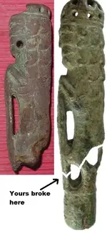

Not seen anything like this.
Its a stylized Lion with mane.
Some kind of copper-alloy but seems to have a iron/nickel content as well, as it has a reddish patination.
Back feet are broken off & seem to have iron residue.
The top is slightly broken but has a ring of holes suggesting it was sewn on something or maybe just a stylized Crown?
There is a hole in the top but only to the depth of the Lions neck.
A hole throw the mouth of the Lion suggesting it may have held a ring.
It has its paws on a very thin shield shape, which has a gap that may or may not have been functional?
Any ideas?

Cru'dad went one step further & found one with a crown:
KNIFE
Unique ID: LEIC-FBED53
Object type certainty: Possibly
Workflow status: Awaiting validation
Post Medieval copper alloy cutlery handle, 68mm long, 13mm wide and 10mm thick. The object is in fair condition and weighs 32.1grams. The handle is oval in section and rectangular in form. It is in the form of a lion on its hind legs with front legs resting on a shield. The lion has stylised curled mane and wears a crown. On a better example such as LEIC-80B261 the lion appears to be amaciated with very prominent ribs. The shield has a strap which sits around the lions rump and his mouth has a circular void running through it, presumably to take a loop.
