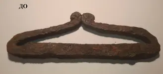

I have a flint, presumably - the times of Kievan Rus
decided to try to restore it

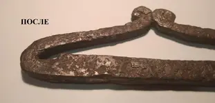

Lightly treated with electrolysis - 30 minutes on a low current. Next, I smoothened the oxides with emery paper and treated it with dremel-medium hardness.
What further advice do you give on clearing and conservation?
before
after

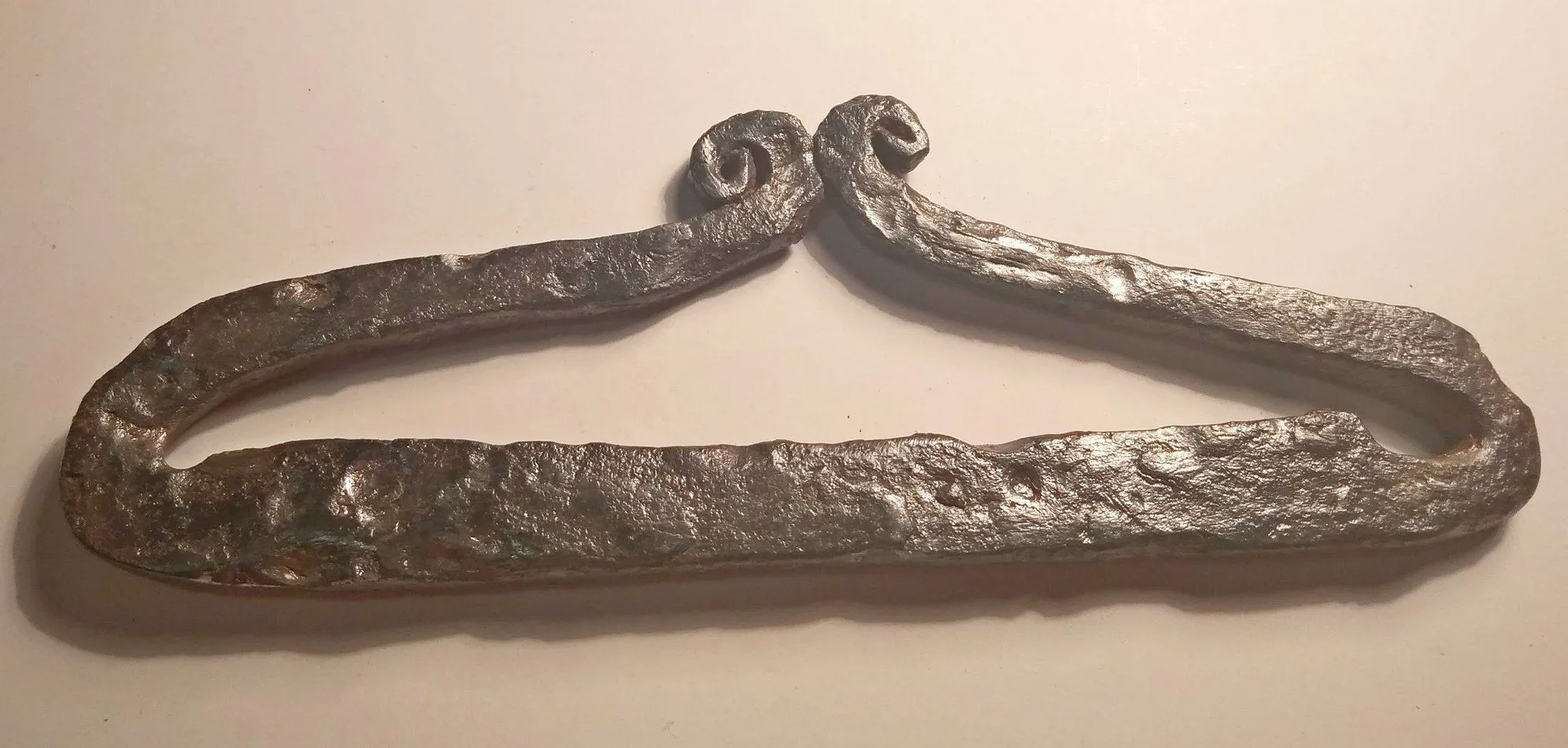

continued to clean.
more photos

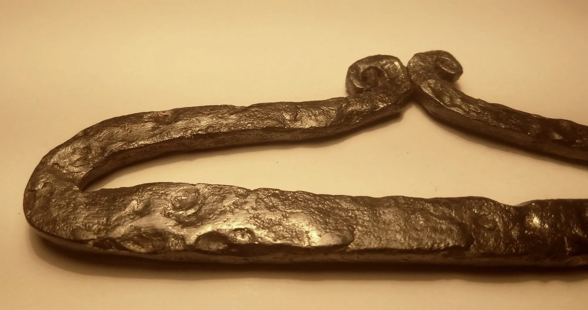

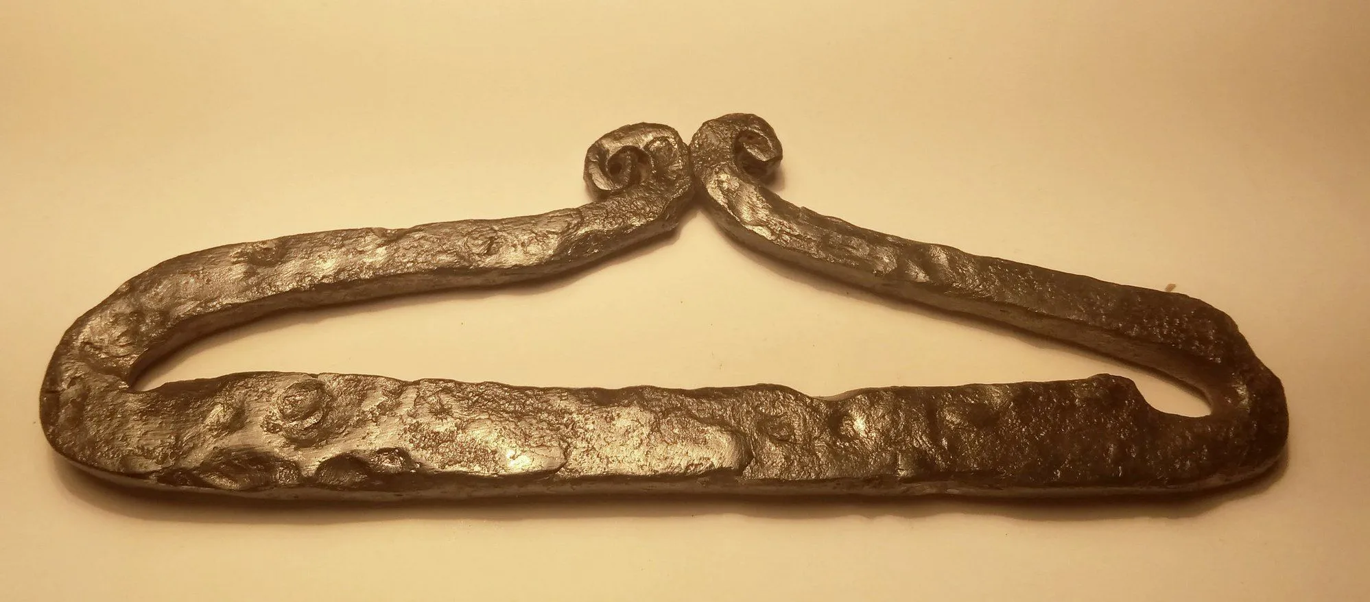

Now I preserve in a vegetable inhibitor (tannin) and will be covered with microvascus
That.looks good I would coat it with something so it doesn't corrode again. Well done
