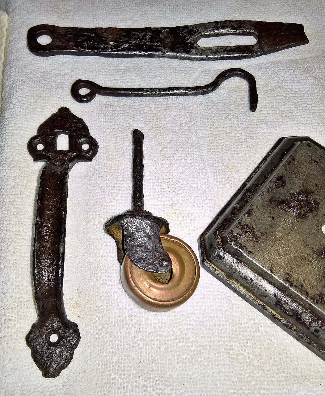

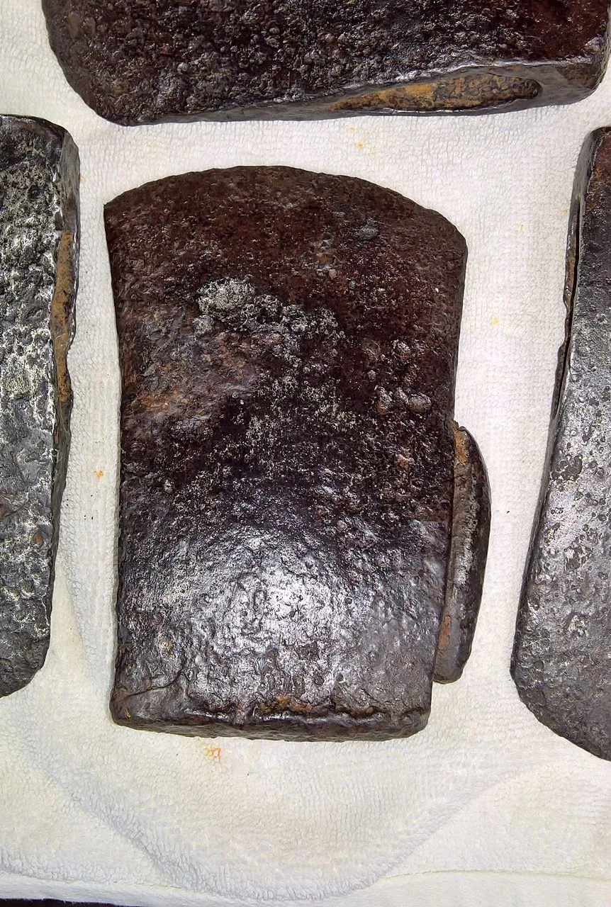

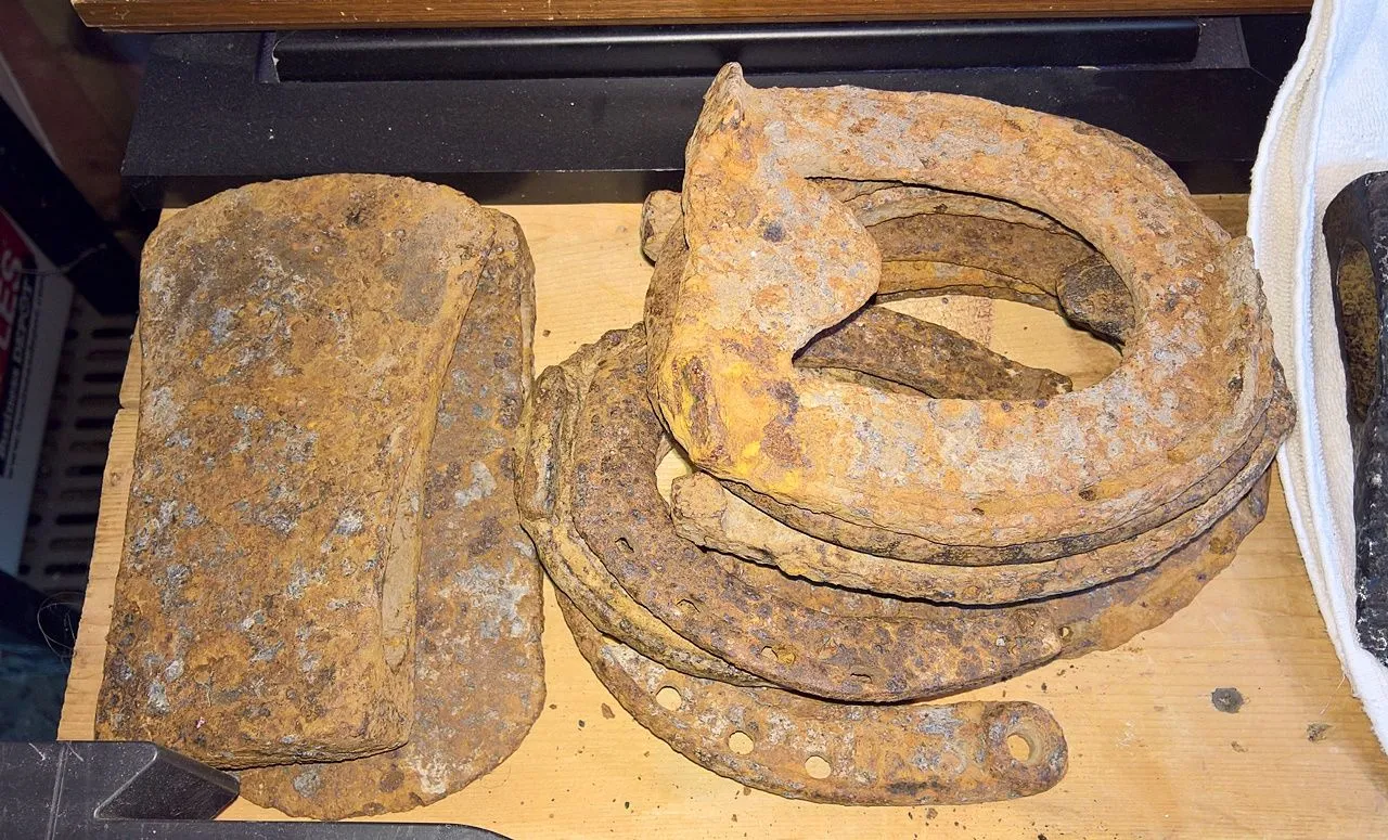

Over the past couple of months while waiting for winter to abate here in the east, I've been tumbling some of my more interesting iron finds. :thumbsup: No great surprises here and I have no idea what I'm going to do with all this stuff, as none of it is really worth displaying out side of my basement workshop. I think it's part of the responsibility we have as detectorists to either reuse, re-purpose or recycle the items we find. All the finds I bring home are immediately relegated to our basement, while I wash and sort them.
My wife has commented, that occasionally I'll 'sneak' a new piece upstairs where she'll notice it on display in our china cabinet. :laughing7:

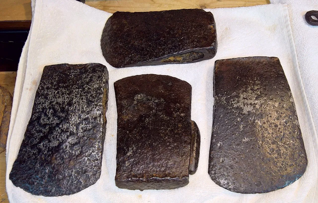

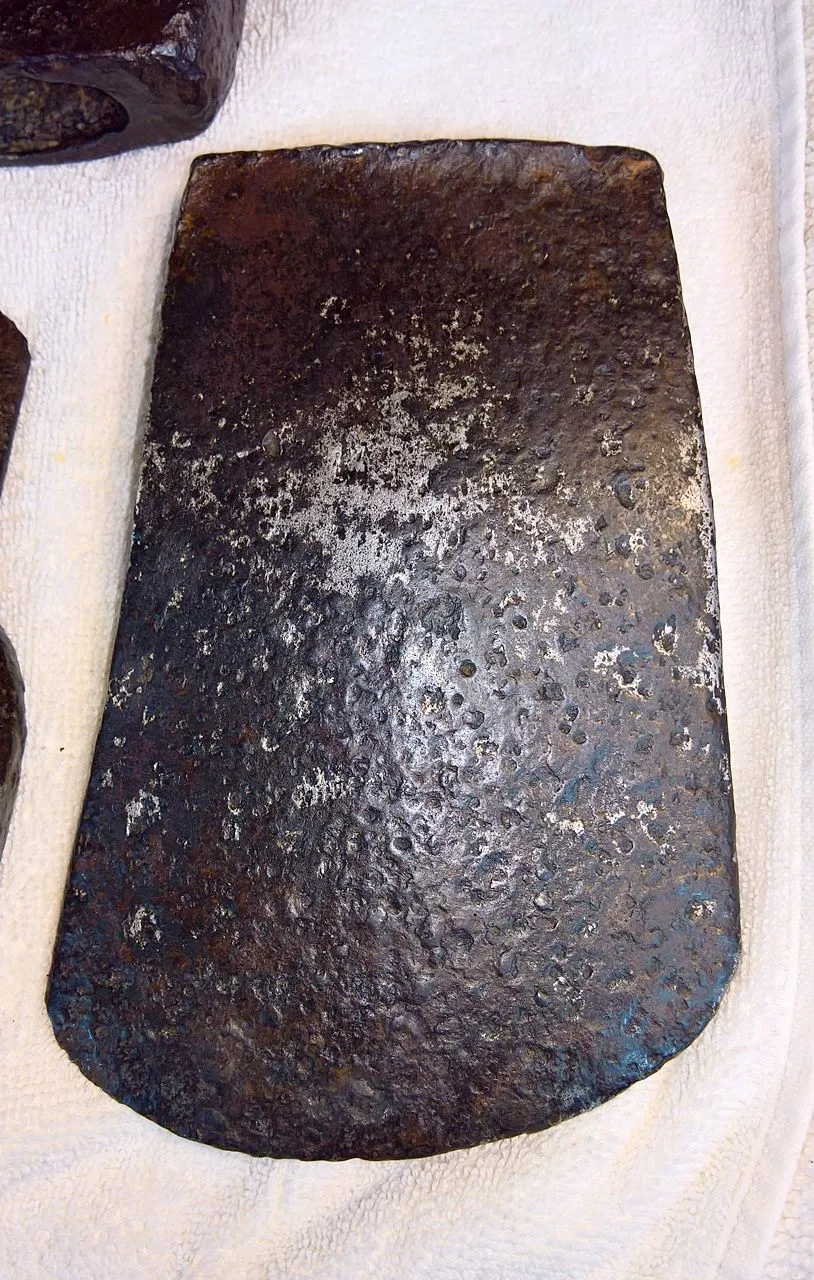

I start by tumbling the items in ½” — ¾” aquarium gravel, a ½ cup of beach sand and liquid dish soap. I let this tumble for 24 — 36hrs, I then rinse it out, refill the tumbler with the same mixture and let it tumble for another 2 days. After a couple of days, I’ll then empty the tumbler, rinse off the items and re-tumble for another 2 — 3 days with just the gravel and the dish soap. Now I need to seal the metal, as it will start to rust again after just a couple of days exposure to the air. So, I brush on a mixture of mineral oil and bees wax, which can be washed off later with soap & water if desired.
I have plans to reuse the door handle and the iron latch on my back-garden gate. I'll likely end up selling the axe heads on Kijiji, as they really should be put back into service. You'll see a picture here of some of the 'eyeball finds' and other items I've found detecting over the years that I'm not allowed to bring upstairs to display! :sadsmiley:

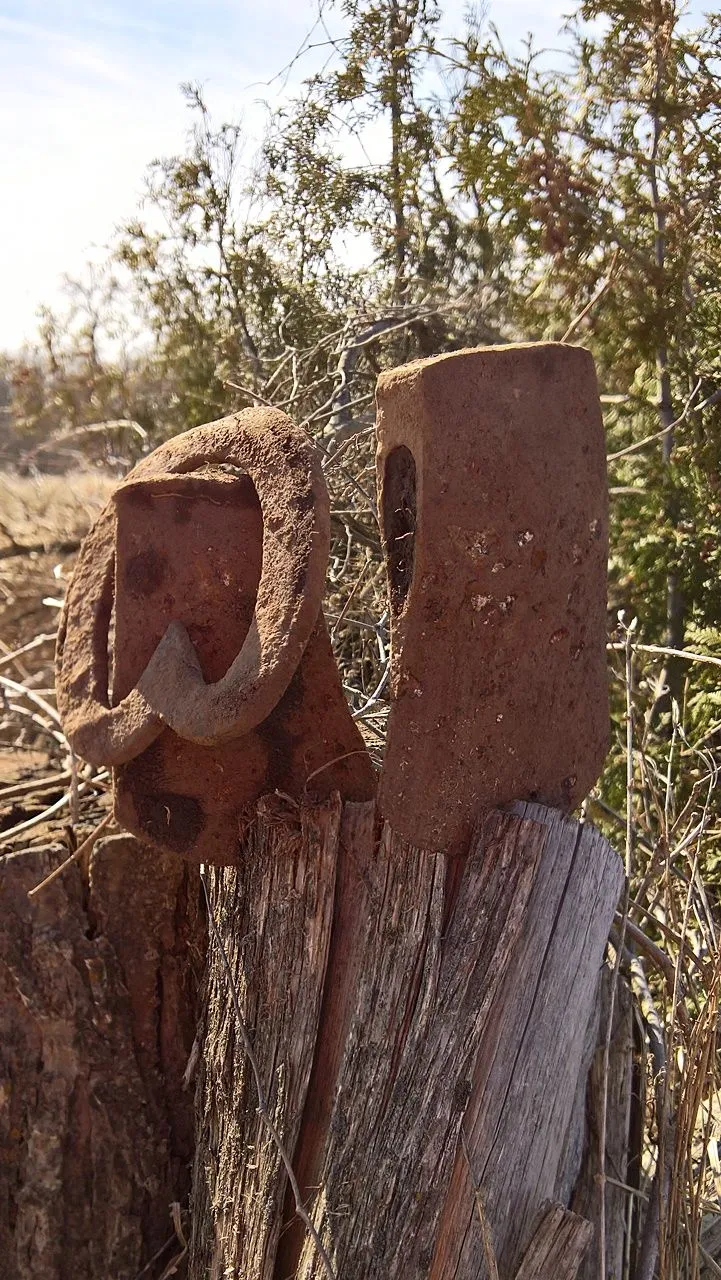

I've also included pics of my latest hunt from last Sunday morning... yup two more axe heads and another bar shoe! :BangHead:
