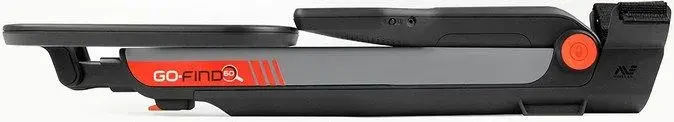

The box was very light and of course I was excited to open it. I knew it was plastic when I ordered it and I did watch several videos and read several reviews. It's not your standard plastic but a hard but lightweight plastic. It was easy to open to full length and put the batteries into it. Because of the plastic, it looks cheap, but remember cheap is a perspective. The display is clear as ever and super easy to use the few controls/buttons. The handle feels like it could easily break with constant use. (Just a thought)

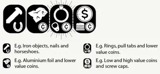

The Go-Find 60 doesn't display VDI numbers like the AT Pro, it has a nice bright picture of one of the four possibilities. Trash/Nails, Foil/Pennies, Tabs/Gold/Rings/Coins and Silver/Coins/Caches. The Go-Find 60 correctly displayed all the test objects.

At this time I am not at all disappointed in my purchase. It's not an up grade, nor a down grade, or a side grade. It has its own purpose like a gold detector does. The GF 60 runs 7.5 hz and my AT Pro runs 6.5 hz. Because of it's weight and fold-ability, it will travel when I do. I will still need a digging device and a pin-pointer to make the detecting easier.

1) POWER SWITCH (ON/OFF)
2) EAR BUDS OUTPUT
3) SENSITIVITY Increase for more detecting depth. You may need to decrease this if there is high noise interference or false signals.
4) PINPOINT (GO‑FIND 40/60 only) Determine the exact location of a target.
5) VOLUME
6) BACKLIGHT (GO‑FIND 40/60 only)
7) FIND MODE Detect and reject metal objects.
8) DEPTH INDICATION Shallow | Medium | Deep
9) TREASURE VIEW LED Red and green LEDs help you quickly identify treasure from trash. (GO‑FIND 40/60 only)
10) FIND ICONS (x 4)
11) BATTERY LEVEL
12) BLUETOOTH (GO‑FIND 40/60 only) AUDIO OUTPUT 1/8″ connector with speaker at rear.

Nice write up. I wish you good luck with your detector. I like the concept of the machine. I had to chuckle when I saw their iron example is "horseshoes" and everything is plural.
